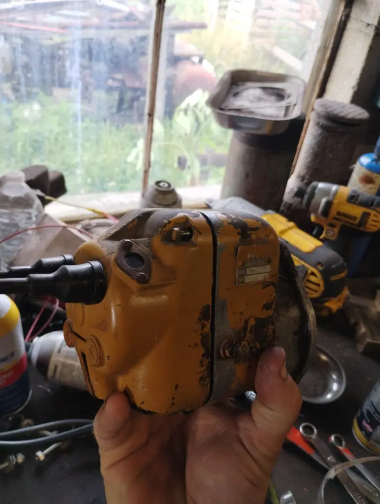

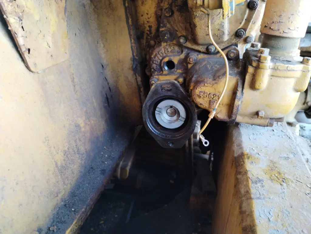

I believe after a little digging I thinking I've got to time the mag drive gear somehow with this style mag. I have attached some pictures of what I'm working with.  I know you can adjust the rotor but with the "MAG" markings lined up on the flywheel it should be at the point where it's breaking the points I believe.  You can only mount it one of 2 ways to the drive coupler. According to the repair manual there should be an "M" stamped on the gears but I sure can't see them anywhere.  I am using Champion UD16 plugs and new solid copper wires. thanks again for the help.

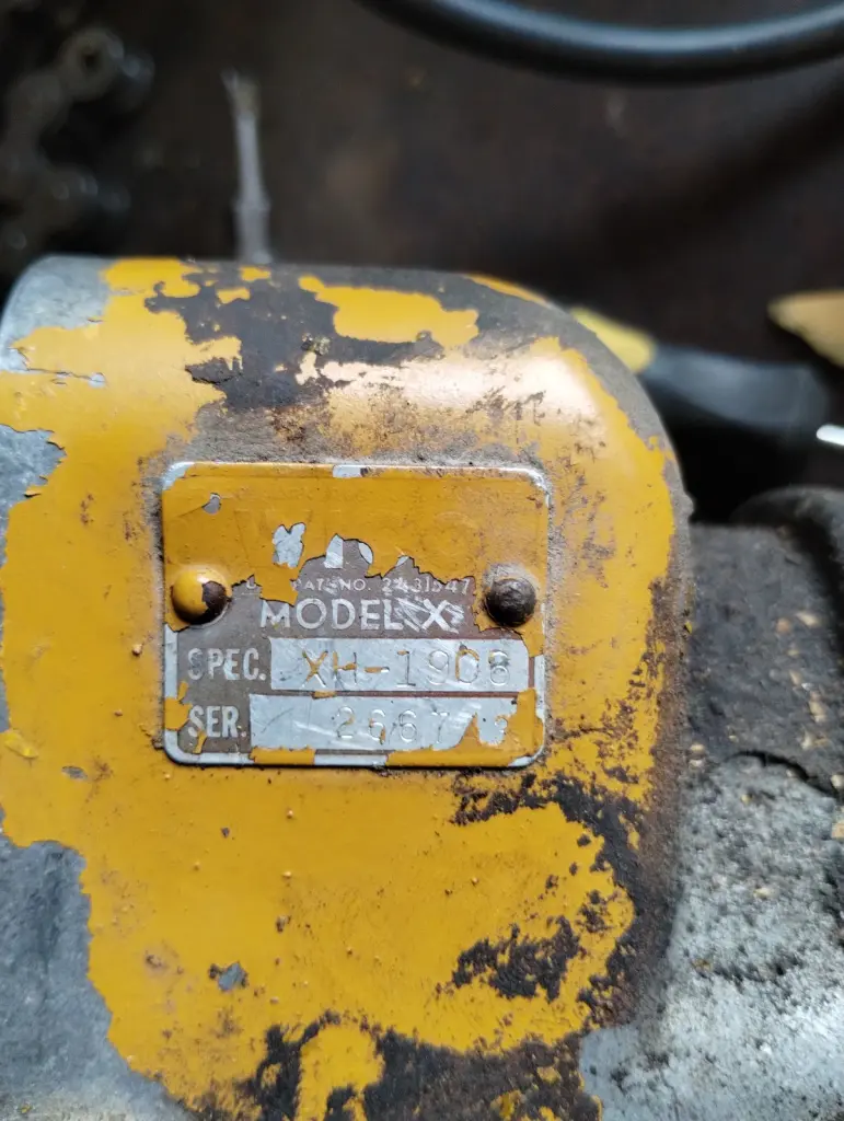

According to my Wico to Cat magneto conversion chart
XH1908 is for early D5,D6,#12 and is clockwise rotation
The D13000 uses XH2837 counter clockwise rotation and replaces the American Bosch MJK 4/2 180 D311

I was wondering if it was the correct mag. something just doesn't seem right with it.  This evening i pulled the timing cover assembly off and was able to find the "M" on the crank gear and I believe the mark on the mag drive as well'(honestly don't know if I had it right the first time or not but it is for sure now). When we bought the dozer, the pony was locked up tight and someone painted everything, so I just assumed it was correct mainly because the rest of the machine is in such great shape and was defiantly a well-cared for machine. I can confirm that the mag drive does turn counterclockwise so possibly it has been the wrong mag this whole time.  Ran out of time this evening to try to see if it would run any better.  I know while trying to set the rotor looking thru the little window there is no way to get it in the center of the

Need to confirm that Mag number. I read it as XH-1908 but if it is XH-1906 it is an older correct unit for the D13000.
Can't quite make it out for sure in the picture.
Hello Old Magnet, I downloaded the photo to my desk top computer. When enlarged enough it definitely reads XH-1906. Nice catch.

Yes great attention to detail!! Thats exactly why I knew this was the place to post questions. It is a 1906 for sure I verified that the other night. Well after making 100% the gear timing was spot on by using a paint pen and marking the "C's" and very hard to see "M's" and checking with a borescope I mounted the mag with the rotor lined up and tried it today and NOTHING not even a pop! After sitting for a while and questioning the meaning of life a bit I decided to pull the mag and turn it 180 degrees just to be sure.  Hit the electric start and bam she took right off and ran what I believed to be almost perfect! This pony motor hasn't run for guessing better part of at least 40 years. (Being locked up for probably 30 of that).  She cracks and pops a bit when not under a load but once the big motor is pulling it down it sound great. I know it brought a smile to my face as well as my dad standing there helping.  He said it sounded smoother than anyone he could remember being around and he grew up running these old cats.  The big motor popped off right away just like it should.  We shut it down after it built a little heat up and tried it again just for fun and the little motor popped right off again.  Will be nice being able to start it on its own instead of having to fire up our old D6 9U to try to tug it around all the time.  Thanks for the help, guys!  Sure enjoy aggravating myself with these old Cats!  I guess on to the next project sitting in the shed a D2 with a stuck hydraulic valve and a non-running pony as well.
