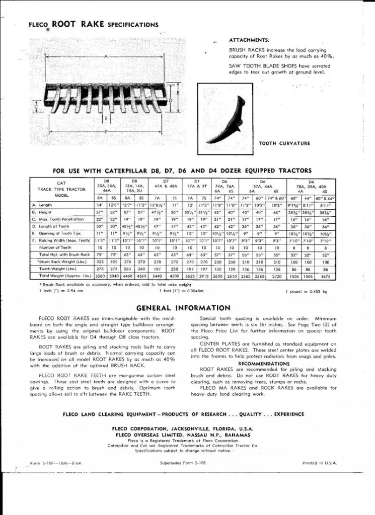

Same gauge tractors but the trunnion part number changes @ 47A3396 & 48A6393-up to the larger D8 size.
2J5462 vs 5J4321

The late Fleco rake with straight push braces weighs around 4800 lbs

That would be correct, that is for the 1970's vintage rake, not the ones with cast tines.

The straight blade is around 7600 lbs
The rake (root rake) is 4200 lbs
