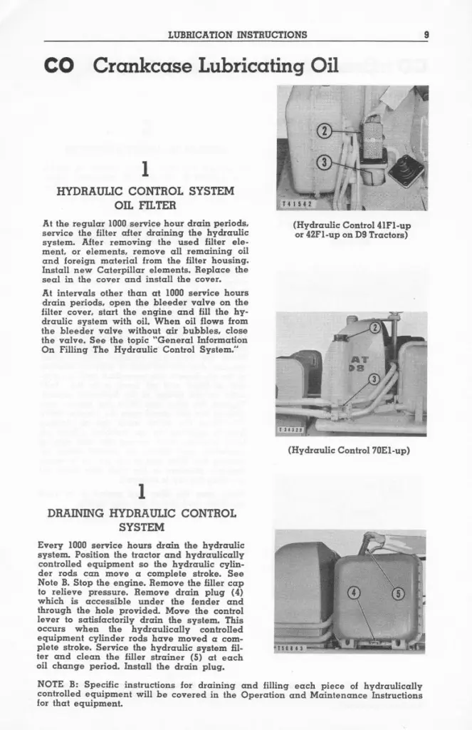

These are pages from the Operation and Maintenance Instructions for the hydraulic control on my D7E. Your hydraulic control might be a later model but the info should still apply.
[attachment=43285]Hyd 1.jpg[/attachment] [attachment=43286]Hyd 2.jpg[/attachment] [attachment=43287]Hyd 3.jpg[/attachment]

Should be checked while machine is level and blade lowered.
