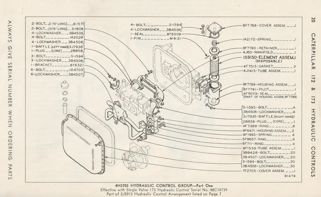

I just got a old D7E serial number 47A11294 and have a few questions about the hydraulic system.From some internet research it looks like I have a #173 hydraulic system. The tank is mounted in a bulge in the nose of the machine. Does this system have a filter and if so any idea where and what the part number is? I'm a new member here, sorry for so many questions!
Tue, Jul 23, 2024 12:11 AM
seiscat
Posts: 1,319
Hi Magneto, The D7E 47A is a great tractor. I need the S/N of your hydraulic control to be sure. The S/N tag is located on the left side of the tank I believe. I think this is what you asked for.
Craig
 [attachment=77190]IMG_20231005_0021.jpg[/attachment]
Tue, Jul 23, 2024 3:43 AM

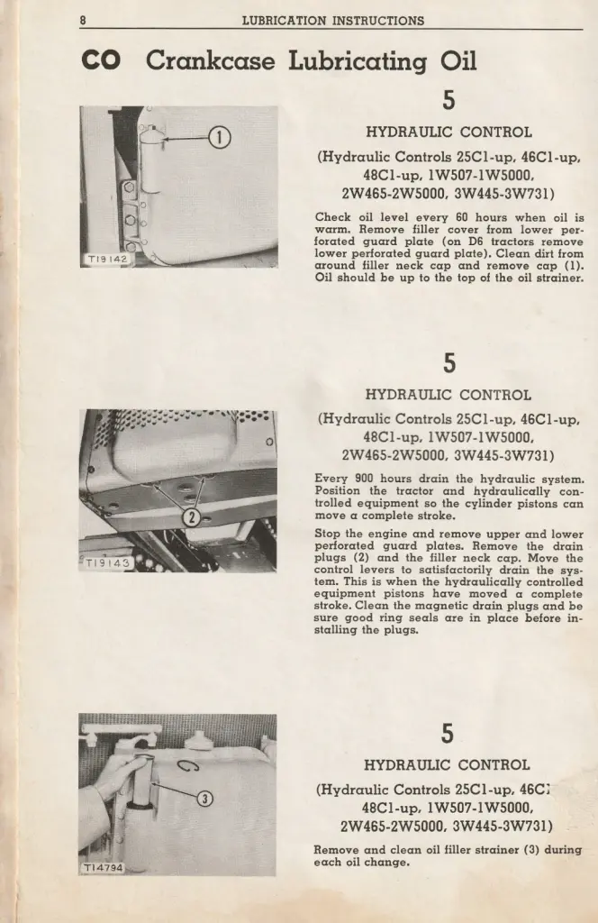

One last question how do I tell when the system is full? The system self-drained yesterday when a hose blew.
Tue, Jul 23, 2024 6:23 AM

If you can use the ACMOC library under "document type" select "operator's instructions." Then under "accessories" select "hydraulic controls." On the left column scroll until you find the NO. 46 hydraulic control(it was later changed to NO. 173)
Craig
These pages are what you need:
 [attachment=77192]IMG_20230811_0008.jpg[/attachment]
 [attachment=77193]IMG_20230811_0012.jpg[/attachment]
Tue, Jul 23, 2024 8:18 PM

BTW Fill the hydraulic tank until the oil is visible in the screen. Start the tractor and cycle the blade up & down several times then shut the tractor down and check the oil level again. The oil level should be in the lower half of the screen when the oil is below operating temperature.
Craig
Tue, Jul 23, 2024 9:19 PM
