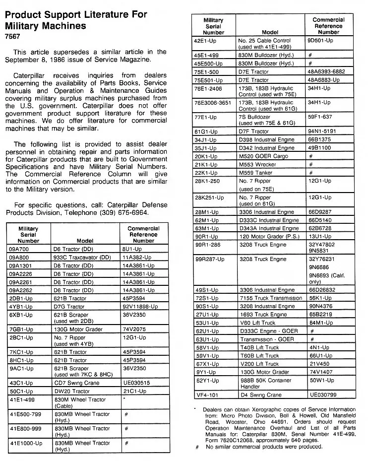

I do not have Rack Settings for Military units, but this equivalent chart shows any D339 powered D7E Military engine would be a 48A Powershift unit as indicated by said chart :-
75E1 to 500 = 48A6393 to 6882, were 1335 +/- 30 RPM and 173 BHP
75E501-up = 48A6883-up, were 1340 +/- 30 RPM and 193BHP.
