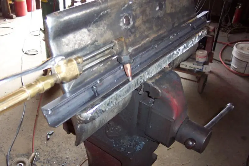

I welded up the grousers on my D6 a couple of years ago. The local track shop had 10' sticks of bar in various sizes. I pulled the track plates off to do mine so I bought a new track plate bolts too. (Otherwise I would have had to work in the cold on a dirt floor)
(12) 10' sticks grouser bar: $359
(280) bolts & nuts $299
My grousers were worn to a pretty good curve too so I clamped a guide to the plates and trimmed them straight with a torch. I mounted them to an engine stand to make it easy to position them for welding.
I (2)pass wire welded them using ER70S6 and haven't had any trouble with them. I did space the grouser off the plate about 1/16" as recommended in some of the literature I've read.
