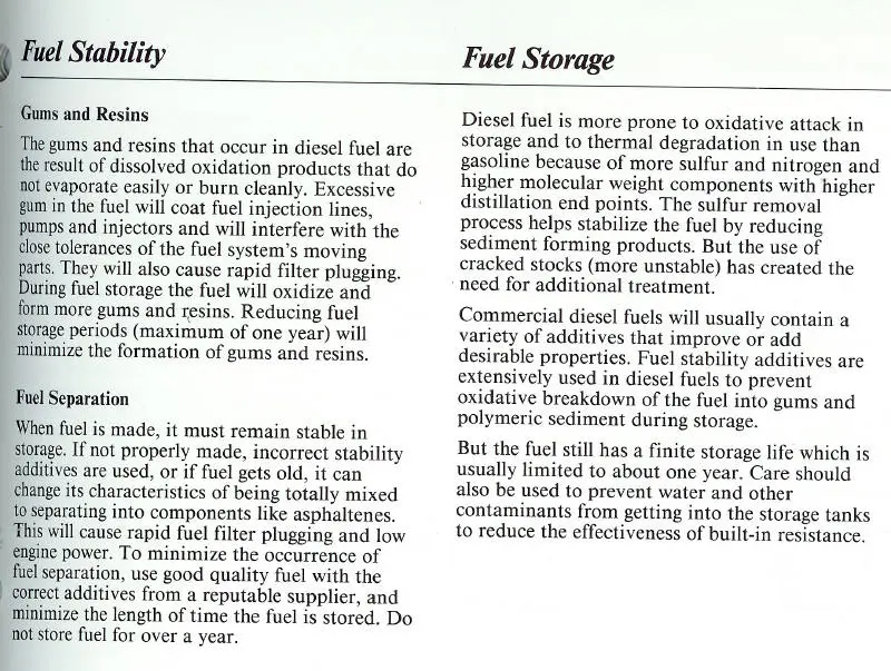

We had a 14A that sat for 3 years back in the 70's when fuel was dark, it would not run until we swapped out the fuel, not sure about the shelf life of modern fuel, maybe someone here knows and can comment.

Fuel storage recommendations are ignored here most all the time....

I would start with a fuel swap first, you could pump or siphon it into 55 gal drum and save it in case that's not the issue. Drain the filter housing too. If the machine sat 10 years who knows what the total age of the fuel would be, it could have been old when it was put in the tank.

Yea im leaning toward draining it all just to be on the safe side. I will check compression and leak down if that comes back good then im going to drain all the fuel and start fresh.
