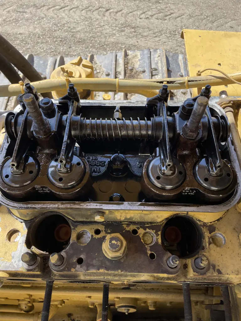

Had to top off radiator with 5 gallons or so after sitting over winter.
Ran machine for 15 -30 minutes. Found black sooty film in rad next morning. I believe this has been ongoing issue.
Drained coolant and pulled number 4 precup. Looked ok. Re-installed and filled rad back up and warmed up machine to find bubbles in rad when revved up.
Coolant has black sooty film again next morning.
I'm leaning towards pulling heads to see what's going on.
Any advice? Thanks

Candidate leakage causes of combustion gas in coolant can be pin holes in pre-combustion chambers, cracked head/s or block, low cylinder liners and failed head gasket. Yes, pull the heads.
As a long shot you might try retorquing the head bolts to see if that has any affect before pulling.

Does anyone know what torque is on the two big nuts that hold the rocker arm assembly down, thanks. Also is there a mark to check tdc for adjusting valves?

Don’t worry about tdc mark. When number 1 valves both rock at the same time adjust number 4 and vice versa. When number 2 valves rock at the same time adjust number 3 and when 3 rocks adjust 2. This is the easiest way to do it. Good luck.
