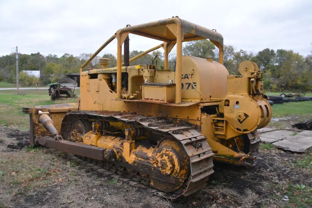

Bought another Cat to go with my D73T and would like to know all the capacities and oil type. It is a D7E-48A550 cable with tilt blade 1962 model with turbo and 24 volt electric start.
 [attachment=66864]C0D20A7F-CE59-43B9-84BB-769344E012F3.jpeg[/attachment] [attachment=66864]C0D20A7F-CE59-43B9-84BB-769344E012F3.jpeg[/attachment] [attachment=66865]1778B770-BF80-42BB-B9F0-90AAD8D36FDB.jpeg[/attachment] [attachment=66865]1778B770-BF80-42BB-B9F0-90AAD8D36FDB.jpeg[/attachment]
