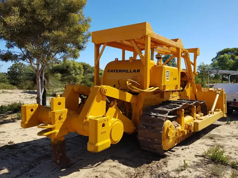

Hi to all from West Australia,this is my first post to the forum hoping someone might might be able to help me.I recently purchased a 1964 D7e 48a powershift dozer and everything is working except my decelerator.It does seem to work at higher revs and i can feel pressure on the pedal but at lower revs there is no pressure on the pedal and not bringing the revs down which makes for difficult driving as i have to bring the revs down with the the hand throttle to bring it to a stop to change into reverse.The hand throttle works fine,no problem with that.Also if i figure the problem out will i still have to use the brakes to bring the dozer to a stop as well as the decelerator or will the decelerator bring the revs down low enough to stop itself.
I do have a manual and was going to see if i could take the spring out of the decelerator tower to see if the spring is broken,unfortunately the the bolt to use to safely take the spring out only threads in half an inch so no luck.I have adjusted the decelerator idling bolt at the bottom of the tower till the bolt cannot be turned out anymore as a locking bolt cover stops it.I was thinking about taking the governor side cover off to see if all is working but i have heard on this forum to be careful as parts might fall out so have'nt yet.The way the dozer is i find it hard to drive having to use the hand throttle continuously and wearing the brakes out.I am new to dozer driving although this is my second dozer,i also have a little 933 traxcavator out of action but i did learn to drive on that.Hope someone can help me as i have learnt a lot from this forum about my dozer,cheers John.

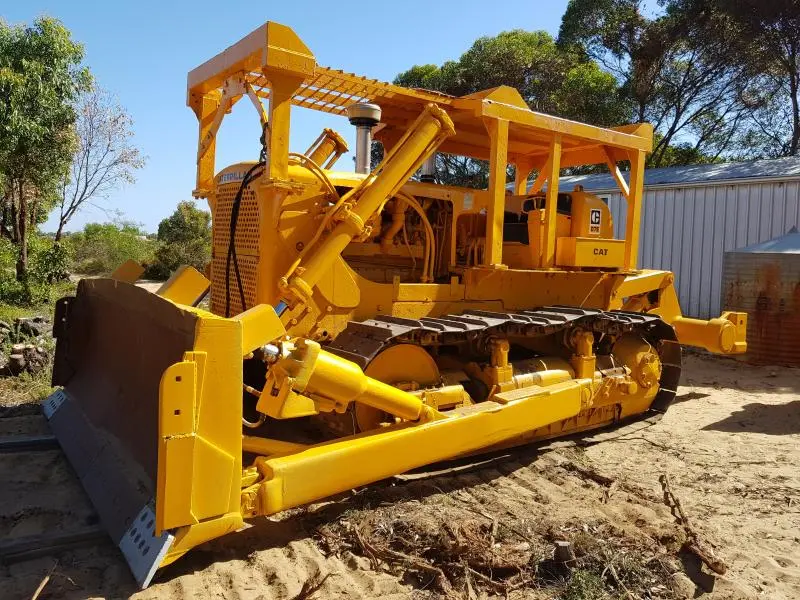

Good grief!! Those blade cylinders must be off an 8! That cab looks like its made for driving through buildings for demo work. You dont need to bring the engine down to an idle when shifting from fwd to rev. half throttle is fine.

The guy i bought the dozer off said it had extra big blade cylinders on it for back in the day a lot of deep drainage was made so the dozer could dig deeper drains.The cab was built i think for land clearing back in the day when bigger trees were pushed and i think it is from manjimup way in the south west where timber was bigger.It definitly looks like a Mad Max machine though.

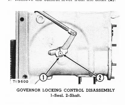

Another wear place for lost motion is on the main gov control linkage lever is a 5/16" bolt up behind the Gov. Housing where the actuation lever is retained to the Gov control shaft--similar deal to the unit above--the bolt usually comes loose and wear takes place.
The bolt body will be well worn by now as well as the slot on the side of said shaft--you will surely halve the lost motion by fitting a new bolt.
It is hard to get at and see and if the lever or shaft needs to come off/out at anytime the Gov unit must be removed to do so.

it is possible/desirable to change the bolt in-situ. Doing just this will improve the looseness/lost motion appreciably--need to orientate the Gov lever for best access, it is reached by coming up from under the housing--old bolt out, new one in, jobs done.
Looks like I confused you by adding about the lever/shaft renewal needs the whole unit out--sorry.

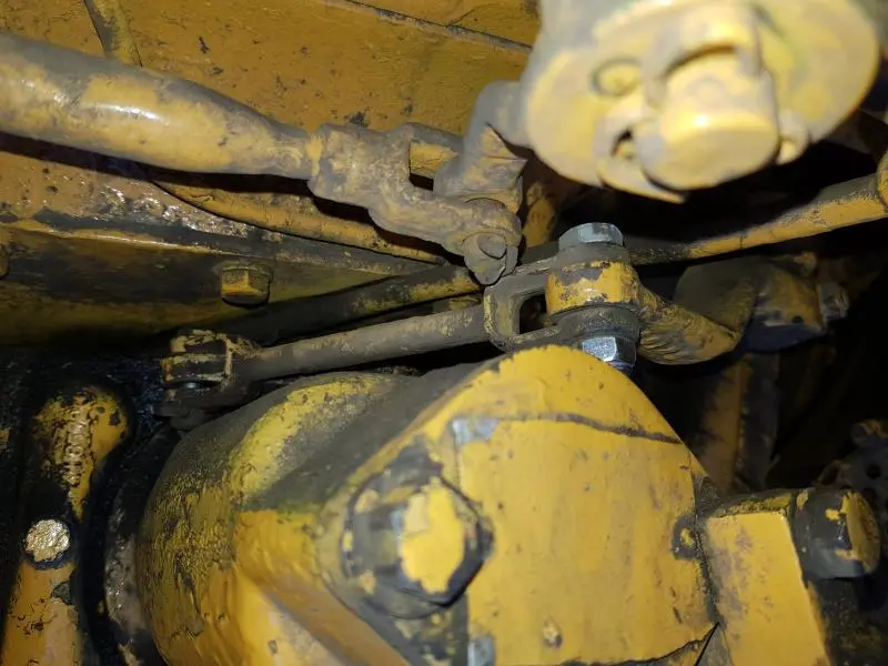

Hi All,thanks for your help,i had another go with the dozer today and checked out the linkages,they are pretty sloppy,i guess a well used machine.The hand throttle although loose still works good,Eddie,i never thought to replace the bolt from under the gov housing and will have another look and appreciate the help.I fired the machine up again today and the decelerator did work at higher revs although that was with pushing my foot very hard on the pedal,at lower revs,nothing unless i stood up and put a lot of force on the pedal(probably not a good practice to drive while standing up),i looked at the linkages again and the linkage attached to the decelerator tower housing moves about nearly 2 inches before it actually starts working,by then the foot pedal is too far down and hard to use.I guess the internal workings are well worn and need replacing.I did think of a short term fix as to maybe making a shorter linkage to the one in the pic so as the pedal would be more raised and easier to use,not sure if it will work but i am after more control at lower revs as i have many trees etc to negotiate around.Not sure if that is just achieved by using the hand throttle alone.
