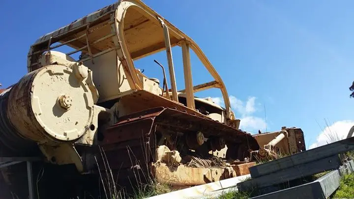

Just bought this monster with the biggest winch I have ever seen. It is a D7D 17A cable blade whistler built in 1960 and has not run for a couple of years due to pilot motor issues. At least every orifice was covered and when last it ran everything was allegedly okay. I got it for just above scrap value and way below market value. It also comes with a spare good track and chain and new PCU friction discs. So if all else fails I should be able to cover costs.
The 7 has only had 2 local owners since new and needs some TLC. The last owner nearly lost it over a cliff but was able to winch it back eventually after first snapping a 1.5 inch cable! He also said that the enighbours complained that when he ran it their houses shook due to the underlying sandstone vibrating!
He showed us some of the work it had done including cutting tracks with 30 foot embankments and big dams too. He also has a couple of nice Olivers which might be for sale.
Can't wait to get the D7 going after which I have to work out how to get it home. I don't think the Landrover will tow it😊
More pics to follow.[attachment=25203]whistler.jpg[/attachment]

Looks like you have an interesting project ahead. The canopy on the machine is unique. I don't believe I have ever seen one made out of rolled I beam before. Looking forward to updates.

is that a hyster D8N winch that's been modified to bolt onto that D7; if so yes she would have some power alright. they actually have 2 speeds to winch with, hi and low. that's what made them so great

Yes Merv well spotted, I had not noticed in the gloom when first looking at it but I just took possession and checked and it is a D8N winch with two speeds.
Allegedly it has dragged trees weighing over 20 tonnes with some ease being 6' in the base and 100' long - but I guess that might be like the fish that got away. The seller also claims to have been offered 5k just for the winch and 5k for the motor but the old feller wanted it to go intact to a good home - one with a 'son' to take it on as a project because his 3 sons were not interested. How sad😞

Yes I believe these were made locally by the Cat dealer and were built to suit the Tasmanian logging conditions where giant trees once prevailed and indeed many loggers have been killed by 'widow makers' that is limbs lodged high in the canopy often falling like spears as a result of machinery vibration and/or weather and wind changes which might not be detected on the ground. One had fallen on a machine I looked at some time ago and it had penetrated thick plate steel just missing the driver! And of course the winch cable present a major risk should it snap - as has happened and left a visible crease in the roof where is whipped back and over the top!!
They are completely different to the scrub canopies used in say Queensland which appear to be designed more for shade.
In any event there's plenty of steel in them😊

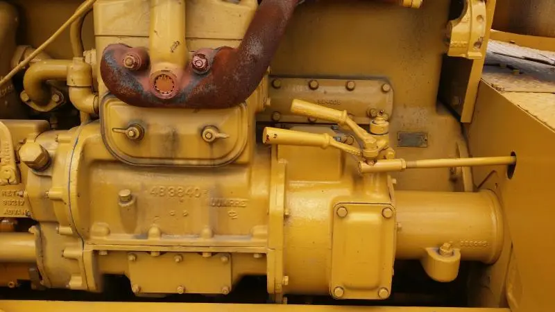

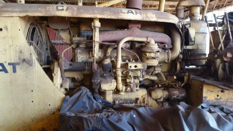

Photos of 17A and 7M pilot motors

Reply to Andrew:
why is the camera in the dirt?
Sat, Sep 20, 2014 6:43 AM
mrsmackpaul
Posts: 1,456
Reply to Andrew:
Andrew your on the ball mate those pilot motors are different anyway as my old pilot motor spends its days underneath a mango tree I thought it might be handy for someone
