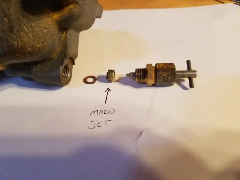

Uh oh...... I broke the threaded section off the main jet. Spent a couple hours online looking for another but all that comes up is the adjustable needle. Am I S.O.L. or can I JB weld it back in? The needle seems to seat firmly in whats left of the threaded section of the jet still stuck in the carb.

Darn it!! That’s the pits, if the needle seats against it ok, I’d try it. Nothing to loose at this point.

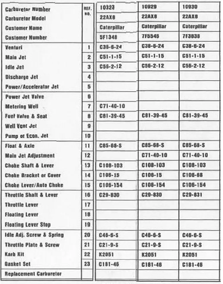

Here is the parts list for the Zenith 22AX8. These are original Zenith numbers.

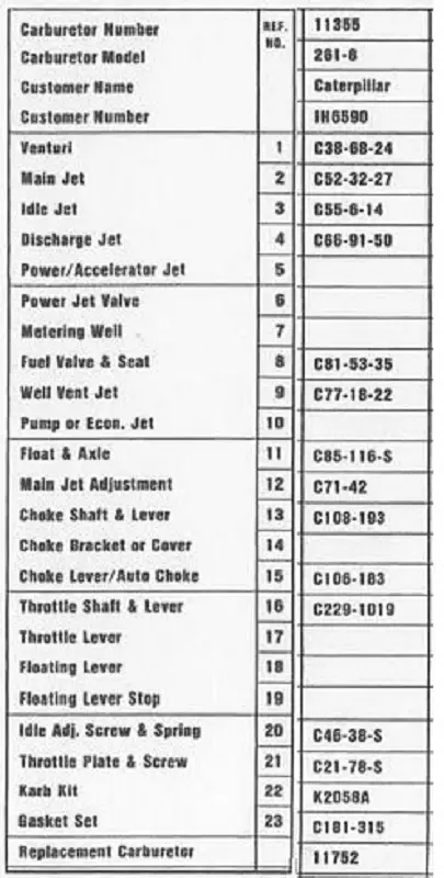

Here's the Zenith parts list for the 261-8

Here is the zenith 261-8 exploded view: http://www.carbkitsource.com/images/Zenith%20pics/Zenith28ADAparts.jpg
http://www.carbkitsource.com/numbers/Zenith/11355.html
Odd duck I have never seen. I don't see that main jet adjuster anywhere on this diagram.

The link to carbkit source does no relate to a 261-8 carburetor that cat used. If you click on the replacement carburetor link, you get a view of a correct 261-8.
Using OM's list of Zenith part numbers, the main jet c52-32-27 converts to Cat no. 9F2902. Which if you go to machinerytrader.com and search for the cat number, there are a number of sources.
Appears that the main jet is common to most updraft pony carbs on Dw 15, 20, 21, D7 17a, D8 14a, d9 18a 19a.

C52-32-27 is a Cat # 9F2902
https://www.machinerytrader.com/parts/construction-equipment/search?partnum=9F2902&pst=starts
