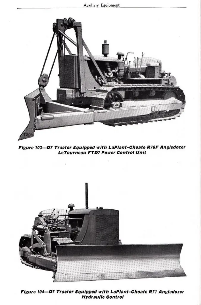

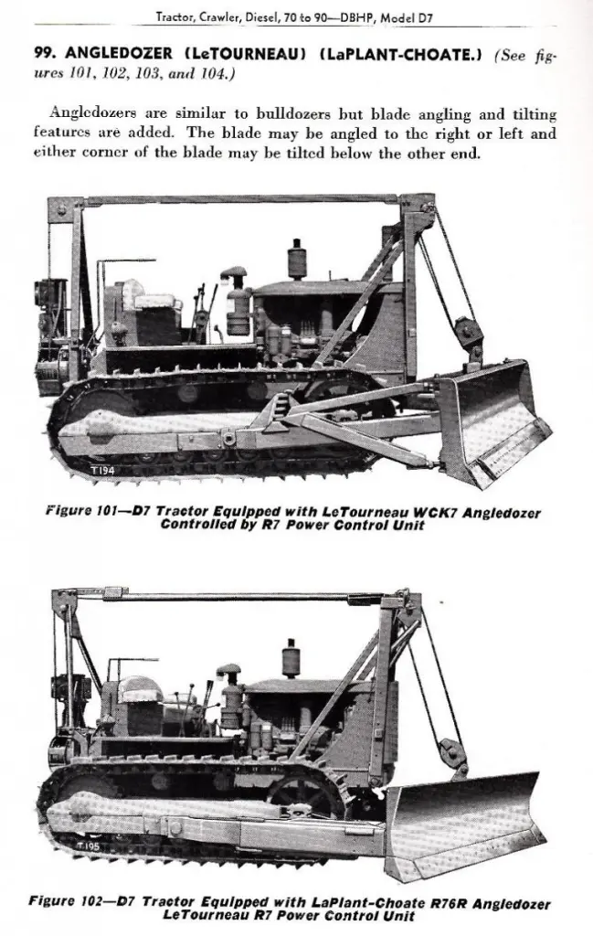

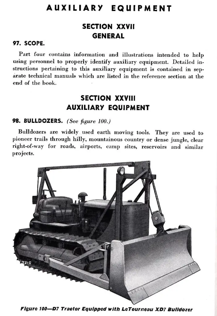

O.K., that sounds like a LeTourneau XD7 blade. Sounds like the poor old girl is in bad shape, so you've made the right decision. It's a shame that it's not restoreable - but not all of these old WW2 warhorses can be saved.
I missed out on buying one for $50 in 2000! It was 3T, but it had no equipment, apart from a dreadful-looking home-built rake - that never even had a method of lifting it, fitted! It was just chained up, at a set height!
I went along to this agricultural clearing sale, and here was this poor old girl in similar shape to yours. Scrap was worth nothing, and even the scrap dealers wouldn't bid on it.
The auctioneer tried to get a bid of $50, but no-one even bothered to put their hand up. I was tempted, but it was way out in the boonies, in the Eastern Wheatbelt, and hauling it would have cost hundreds and hundreds of dollars.
She may still be sitting there today, but I think perhaps she went to scrap when scrap prices went ballistic around about 2008 to 2010?
Here's some scans I did, so you can identify the various makes and models of attachments.

Thanks Oz, very helpful.
From the pic, it appears to be the XD7 blade.
my tractor has the cable running along the right side in a pipe rather than overhead as in the pic.

greengiant - That style of cable location marks it as a later model tractor, whereby they did away with the overhead "headache bar".
It would be good if you could save the blade and PCU from the scrappers if they are O.K., as they are quite possibly useful to another Cat owner - and you would more than likely get better than scrap value for them, if sold off as working attachments.
