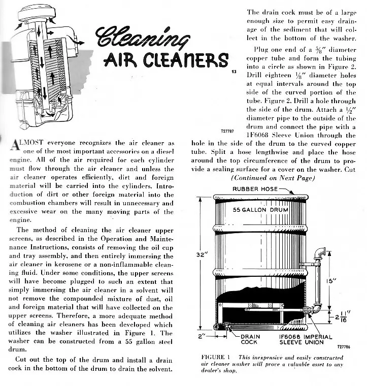

Hi Team,
the scans below may help with cleaning these beasts. They are from a Cat publication. We had one at The Dealers--yes, it was the Apprentices job to clean them when we were doing our time in the Engine Shop.
A big problem with pressure washing or steam cleaning the upper section is to get the moisture out and dried as well as the dirt therein not being completely removed before refitting and then being drawn thru into the engine.

Add this instruction to the mix.
The D7D used oil bath to 17A11432 then had an optional field installation (vertical) dry type which became standard at 17A11879-up.
D7E used oil bath air cleaners to 47A11431. At 47A11432-up there was a field option change over to dry.
At 47A3396 to 3677 the air cleaner was vertical dry then changed to horizontal dry at 47A3678-up.

Hi OM,
thanks for adding the scan about NOT Steam Cleaning oil bath air cleaners. I knew there was some reason not to but had not found that article as yet.
