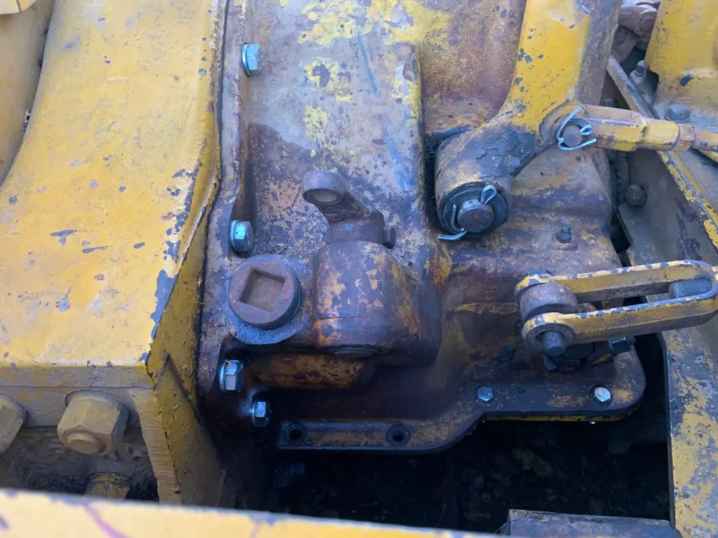

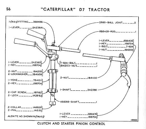

Sorry but I am having trouble visualizing your issue.
As a starting point this pinion engagement is done mechanically by the lever system that has nothing connected to it in your first picture above--these are not a centrifugally engaged pinion.
Scan below shows the controls.
Toby's RD6 Starting Sequence tutorial holds good for your D7.
https://www.youtube.com/watch?v=OiUL4UkERls
If this is missing your issue then keep supplying info until we get you past it.
In a pinch you may need to remove the Main clutch top cover and operate the pinion by hand as explained and get us some pictures of the issue if you can replicate it.

I disconnected lever system because I was only getting 1" movement in the lever that contacts the rear of the pinion sleeve. When I started the pony engine, I could see the pinion sleeve spinning. I feel the new pinion gear is not engaging with the flywheel ring gear because it is brand new. I am positive it is the right pinion gear, before I installed the upper bell housing; I tested the pinion sleeve to make sure it was working correctly. The pinion gear slipped past the ring gear on the flywheel and it took me 1/2 hr using number 9 wire to get it back to the proper position. I will try prying on the sleeve with screwdriver and if that does not work; I will push start the old Cat and see if vibrations from old girl will free the pinion sleeve.

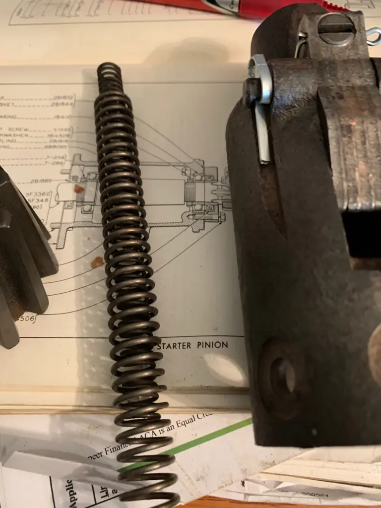

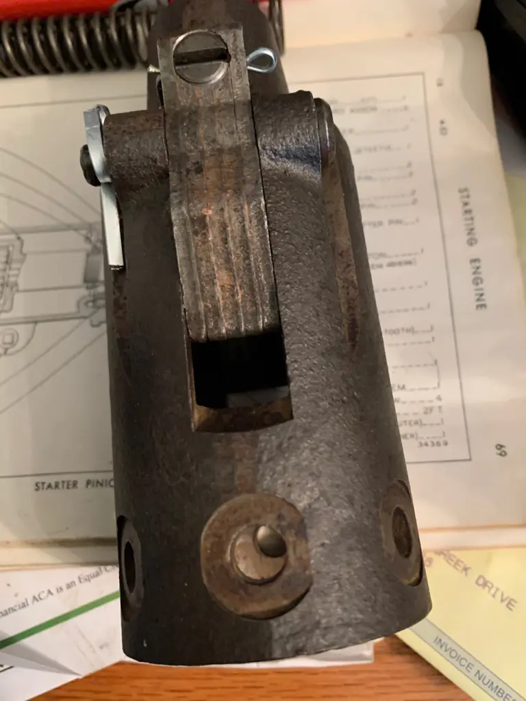

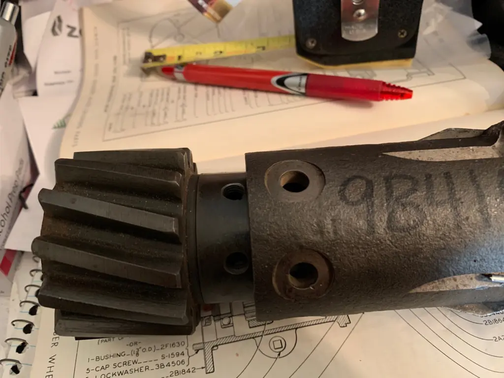

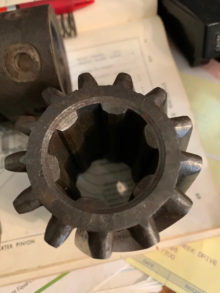

These are pictures of my rebuilt pinion sleeve and pinion gear. John

When you say pinion slid past ring gear, was that with sleeve attached to pinion? That should not be possible if it was. Were you able to get pinion and sleeve to engage ring gear and latch by hand before you put cover on? You say there was square nut on end of shaft, the latch plate would be screwed into end of shaft is a round disc with two flat sides. Also were the compression springs and a rod inside the shaft with rod sticking out through latch plate.. Without those, pinion would unlatch but would not positively disengage from ring gear
Pinion turning with pony running and and diesel not rotating means pinion is not engaged in ring gear and thus latches are not locked. If the pinion and sleeve moves at all, you should get gear grinding when you attempt to engage pinion, even if it did not engage..
If the original destruction of the pinion sleeve was by clutch failure that took out side of bell housing, the pinion shaft could be damaged. I have seen cases where clutch either bent or in one case broke shaft off.

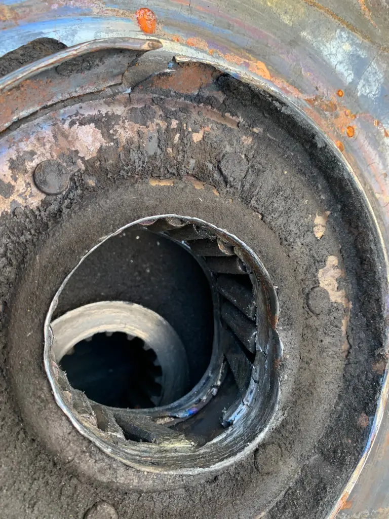

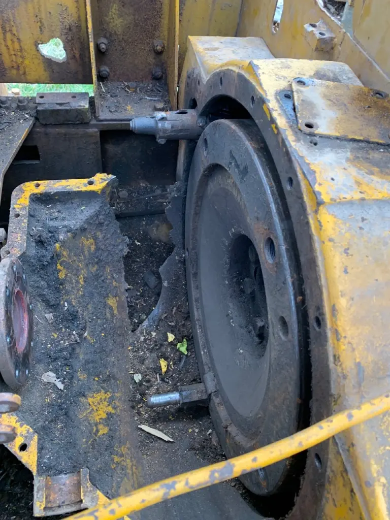

What ever happen in its previous life destroyed lower bell housing. And the flywheel clutch looked like this prior to me rebuilding. All the links were destroyed, and yet the old girl still moved under its own power. Thank you John

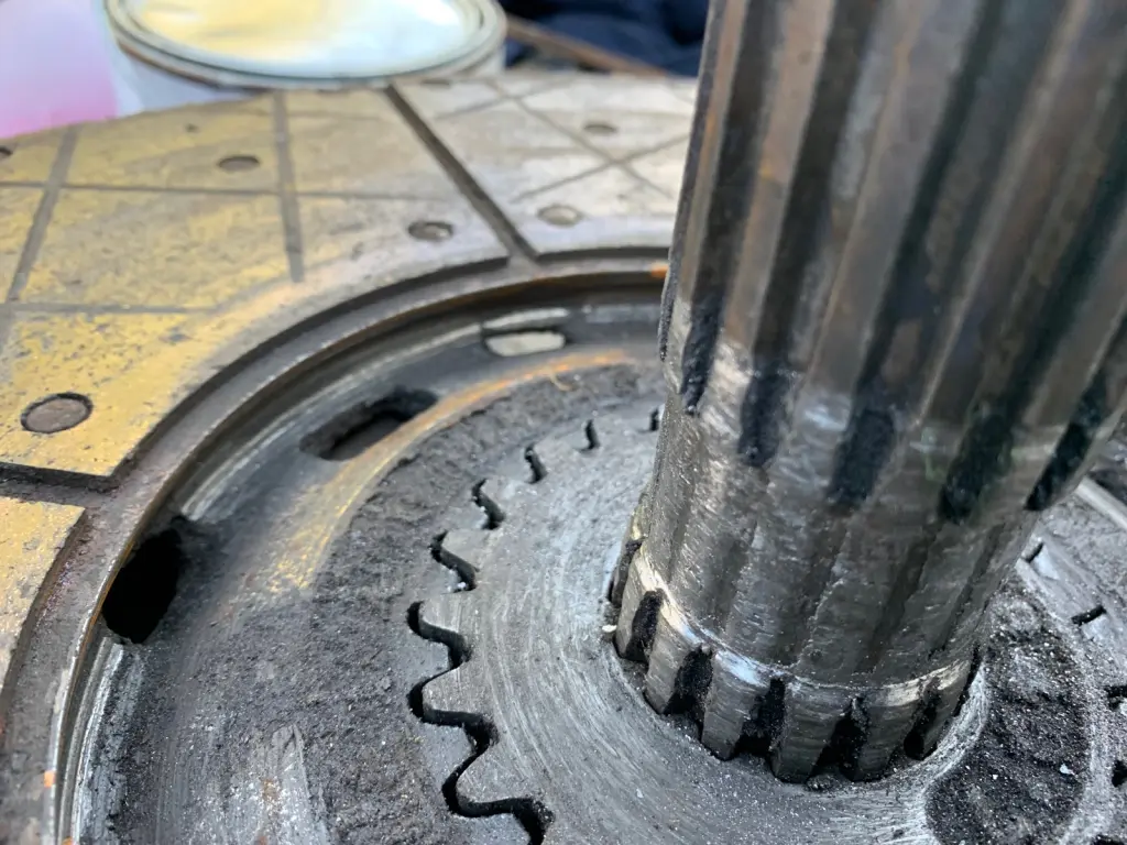

This is what the upper bell housing looked like. I was able to get another upper bell housing from Jon and very much appreciated getting it. That is why the pony pinion linkage is not going to be the same. I do not know if that was a Caterpillar repair.
What would have caused so much damage in the first place?
I want to know if the pony engine transmission that the videos show; can be removed without pulling the pony engine? I want to keep the pony engine as it crank starts with two pulls.
