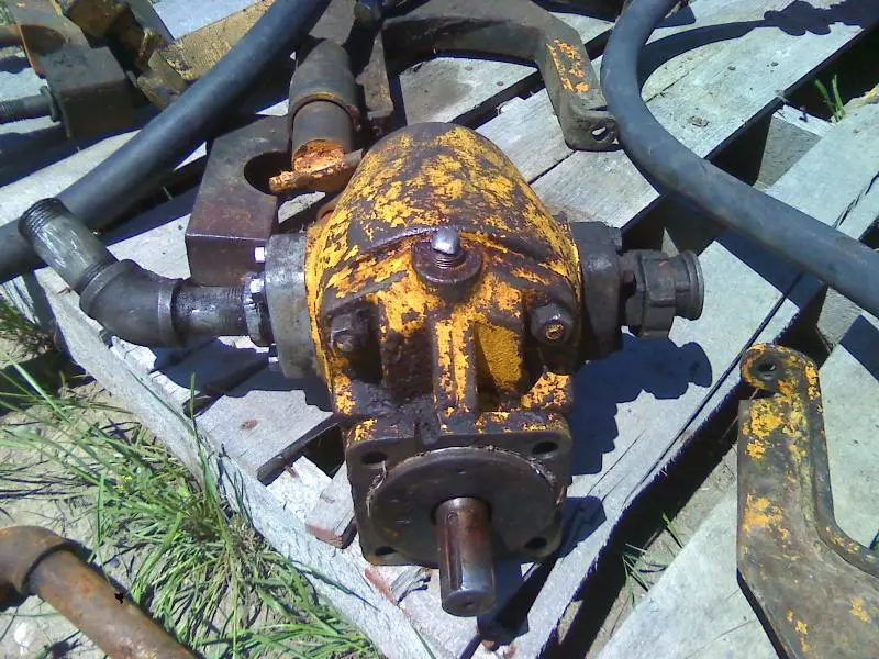

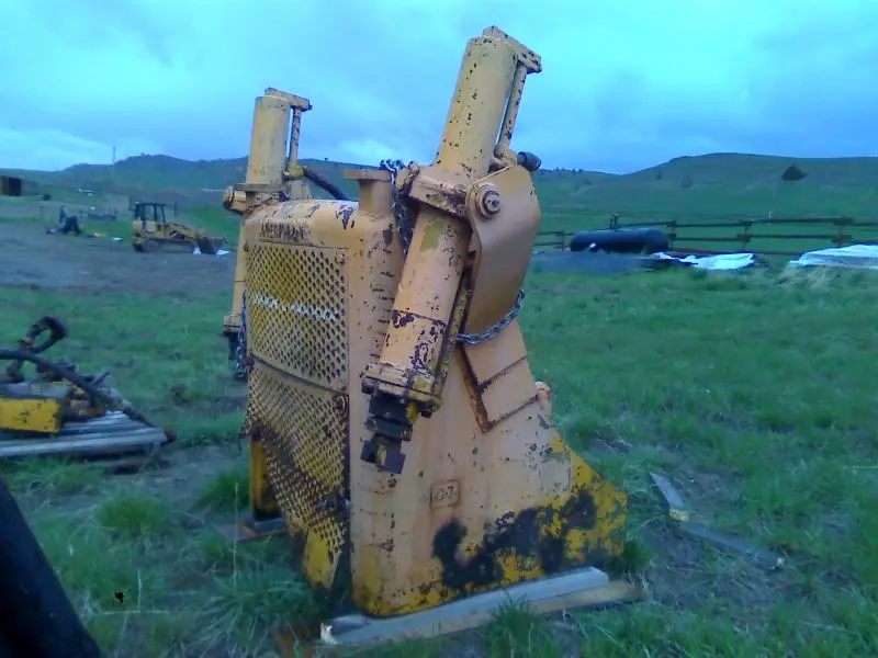

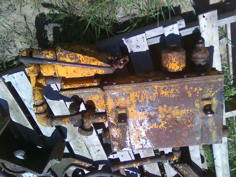

[attachment=23480]D7 17A (5).jpg[/attachment][attachment=23481]D7 17A (2).jpg[/attachment][attachment=23482]D7 17A (3).jpg[/attachment]
I don't recognize that unit although it does somewhat look like Laplant Choate. Finding a manual might be tough. Maybe Kelly can add some insight.....
Is there a name on the pump? BeGe maybe?
clay,
Well, OM is right on. What you have is a pair of LaPlant-Choate hydraulic dozer cylinders and there mounting brackets weld to the cat dozer radiator guard (shroud), by close inspection you will find that the welding is not a factory weld. The only thing Caterpillar is the radiator shroud. As for the tank, and pump I don’t recall a LaPlant-Choate tank as the one in the photo. But, I can’t say it’s not, same with the pump, I don’t recall having an experience with the ones in the photos. I know, no “silver bullet”.
Hope everything works out for you.
Kelly

clay,
Kelly
This is the Laplant Choate unit that sort of identifies the cylinders but that's not the pump system that LC used unless there was an alternate version?
