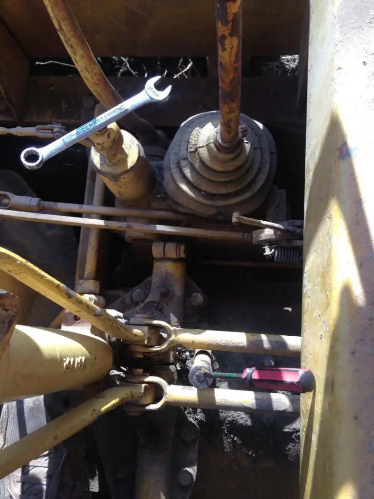

[attachment=22717]IMG_0173.jpg[/attachment] Good Day All. Attached pic illustrates. I am topping off trans gear oil and wanted be solid sure of this. Oil is about one inch from full when checked (screwdriver on dip stick). Wrench sitting on trans gear add?? Just wanted a lil input plz if someone has seen a lot of these and also exactly best type oil to add. Thank you all always.

The d7-3t transmission use 80/90 gear oil

Hi John,
scan below shows you are on the money with check and fill points.
