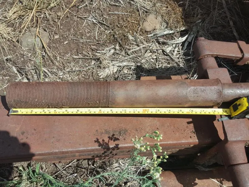

Does anyone know how many inches of travel the screw type adjusters have. as in how far do the threads go back into that casting. Im fixin to need to turn them out a little but there's already about 4" of threads showing and I dont want to drop it out of there but going to far.

Here is a photo of a D7 track adjuster shafts.
Probably should keep 2 inches inside the nut section.
Thank you sir. Pic answered my questions!!

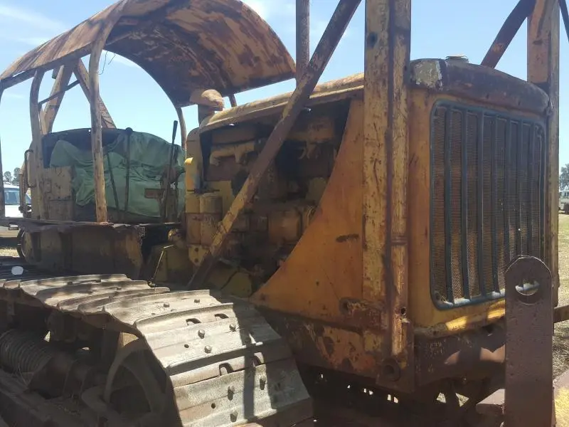

I am glad the information was of use to you. This is a random photo of a 3T.
