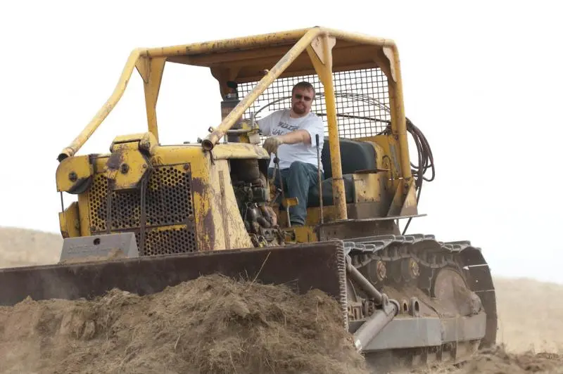

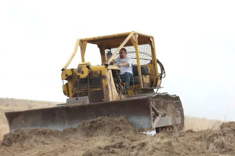

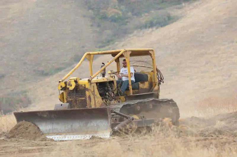

Here is a couple shots from last weekend after I got it going
