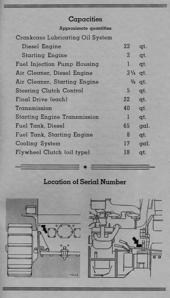

I cant seem to find a full list of fluid capacities for my D7-3T. Also my Cat 24 CCU. Including viscosities

D7 7M1-7M9999 AND D7 3T1-3T28058 capacities:
[attachment=38393]IMG (2).jpg[/attachment]

Most excellent. Thank you sir

Uses 90wt gear oil in finals, transmission and pony transmission.
10 quarts 90wt gear oil in the #25 & #23 CCU.
Everything else is straight SAE 30
Current recommendation for the oil clutch if you have one would be TDTO
T0-4 spec SAE30
