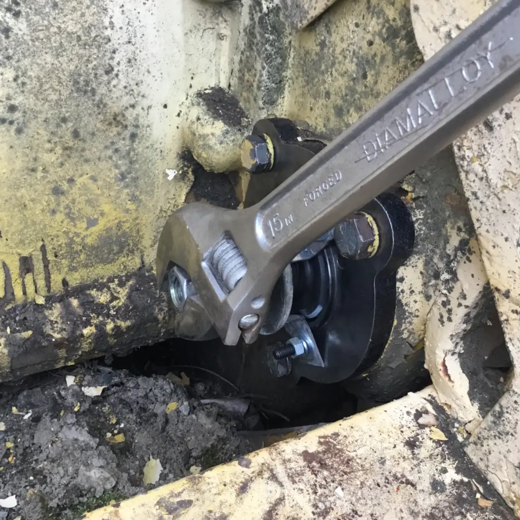

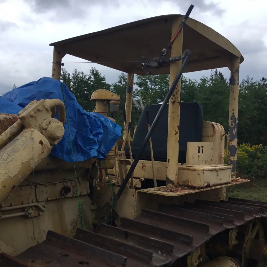

I have a 1956 D7 with a stuck engine. It hasn’t been started in about 6 years. Initially I thought the starter was bad because it smoked when I tried to turn the engine over. I had the starter rebuilt and purchased new batteries. That didn’t solve the problem. The ground terminal on the battery melted when trying to start the dozer with the rebuilt starter and new batteries. I thought about removing the radiator and hydraulic fluid tank to gain access to the crankshaft pulley so that I could manually rotate the crank using a large socket wrench and pipe for leverage. Instead I used a tool that I made using a starter mounting flange, a pinion gear, and a shaft with a welded nut. I then used a 1/2” breaker bar, 1-1/8” socket, and pipe for added leverage to turn the nut, pinion gear and flywheel. When I wasn’t able to turn the flywheel using the breaker bar, that confirmed that the engine was “stuck”. I removed the injectors and valve covers. I didn’t see any rust or water. There was a thin coating of oil on the components under the valve covers.  I then sprayed PBBlast into each cylinder. After unsuccessfully trying to manually rotate the flywheel I then added a cup or more of Lucas Oil treatment diluted with mineral oil to each cylinder and let that sit for two days. I tried again to manually rotate the flywheel but to no avail. I made sure the clutch was disengaged and the transmission in neutral.After unsuccessfully moving the flywheel with a breaker bar I then resorted to using a come along and pipe for leverage and ended up breaking the end of the breaker bar. I then used a large adjustable wrench, a pipe for leverage and the come along, and left things in tension. I plan on getting back to the dozer in a couple of days.The large adjustable wrench is all I had left in my arsenal of tools. I can see that the wrench doesn’t have a firm grip on the nut. Anymore cranking on the come along may end up stripping the nut. I’m thinking about making another tool by welding a 1-1/8” 12 pt wrench directly to the leverage pipe.A question I have is can I access the underside of the piston and cylinder by removing one of the side plates? If so I could I then spray lubricant into that area? Any help, insights and responses greatly appreciated!

did you note any back and forth movement in the flywheel to indicate if it may be something simple like the water pump or other accessory being seized--flywheel movement in this case would prove back lash in the timing gear drive train.
If no backlash then one or more pistons are stuck in the liners--back and forth force will likely have abetter result than pulling in one direction--be aware excessive force on the big bar may shear off a ring gear tooth with disastrous results.

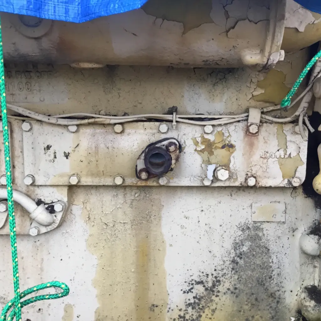

You can access the lower end of the engine thru the side covers--I have done an in-chassis overhaul of one of these at the Dealer way back--we fitted new liners pistons and big end bearings which were accessed thru the side covers--expect some knuckle skin to be removed.
Before you break anything major I would suggest to remove at least the exhaust manifold and see if water has entered via the exhaust system and hopefully not via cracked heads , rusted thru pre-chambers or liners.

I’m not sure if there is any movement in the flywheel - can’t see the flywheel. And I don’t detect any movement in the fan or in the universal joint. I’m going to take the side covers off and inspect and lubricate as much as I can. I’ll also remove the exhaust manifold and post some photos.
