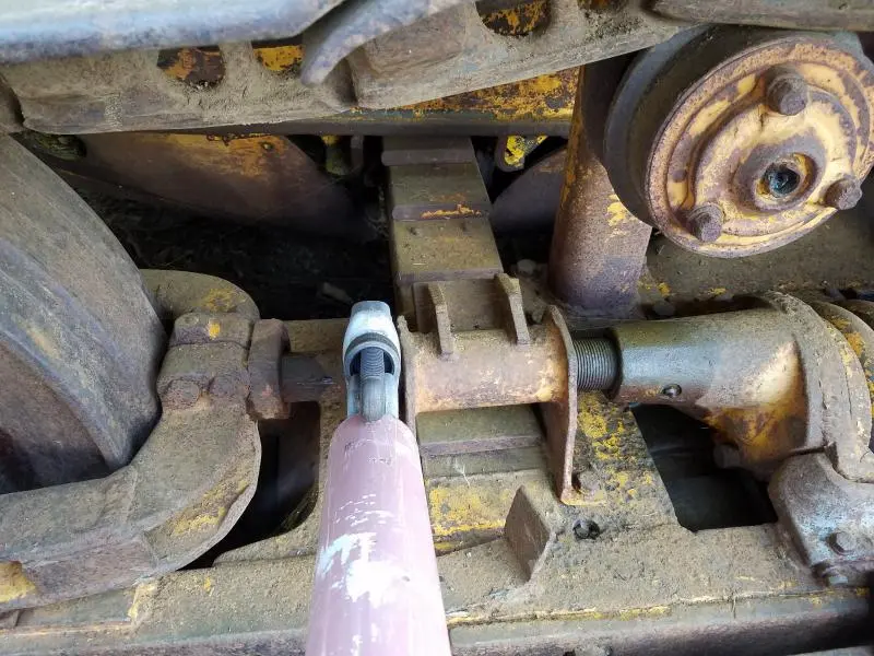

36 inch pipe wrench. 10 ft cheater bar. PB penetrating catalyst sprayed liberally twice daily for 2 weeks. Wont budge AT ALL!! Spent a couple hrs searching to no avail on how to get this to turn. What am I missing?

Pretty sure you will need to loosen them bolts on the idler yoke first

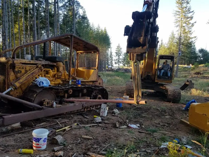

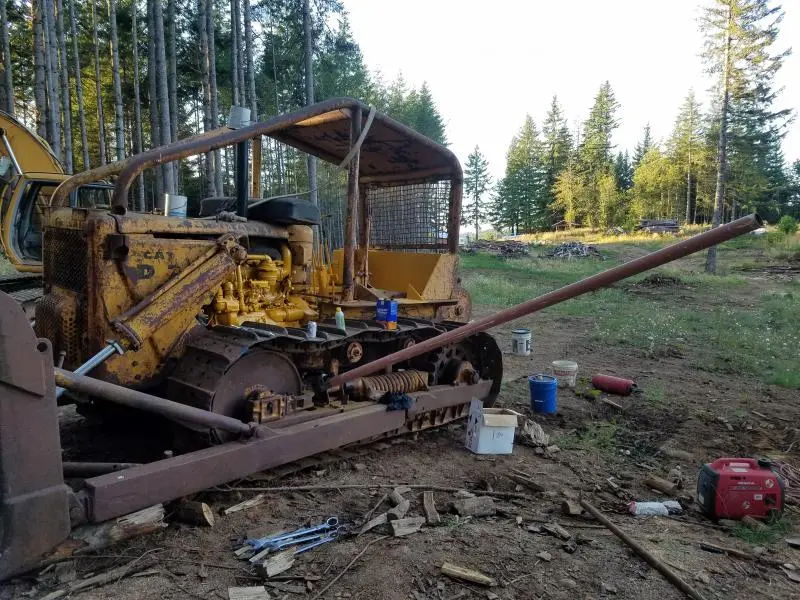

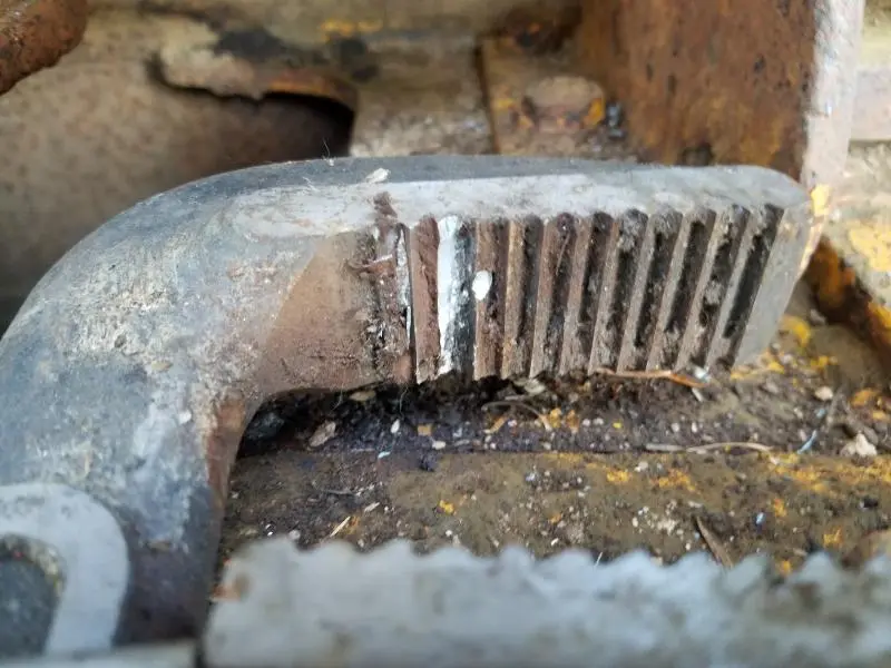

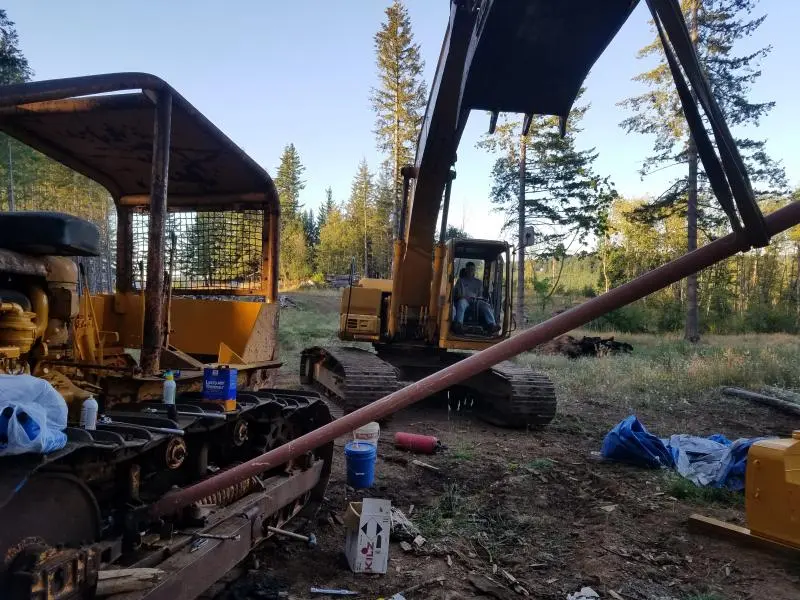

Been workin so much its been hard to spend time on the old girl. Lots of torch gas used. Got all the yoke bolts out. Not by choice though. Broke one 3/4 inch ratchet. All 4 yoke bolts. One 3/4 inch breaker bar. The socket itself split. And a tooth off of my 36inch pipe wrench. That tooth is now firmly embedded in the yoke to spring shaft. Look at the pics and you'll know why. What do you folks figure? Somewhere around 4-10,000ft-lbs of pressure. Had my boy in the JD 200 on the 10ft cheater! What the heck is next?!
