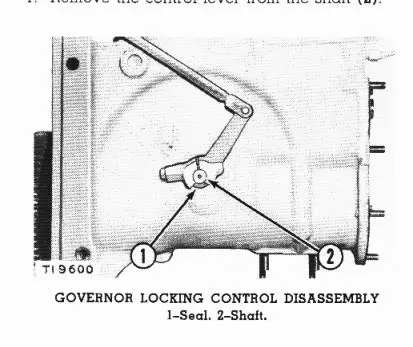

a place for lost motion on the gov. control is in behind and under the gov. housing as shown in the scan. From memory the lever bolt is a loose fit in the hole in the horizontal gov. control shaft and so wear both parts. Changing the bolt will markedly reduce the lost motion here.
The gov shut off takes a fair push forwards with your body weight behind it to set to shut off.

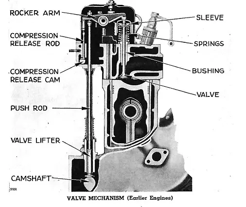

Your compression release rods need adjusting in under the rocker covers. The grey Operators Maintenance Instruction book describes how to do this for the comp. release rods.
They are adjusted at the same time as each cylinders valves are adjusted (valves closed) and are done with the release lever in the RUN position.
Comp. release clearance is 0.025"-0.030" These should be adjusted each time the engine valves are adjusted. Scan above shows early engine but is basically the same as later, I have this scan to quickly show you the comp release rods in question.

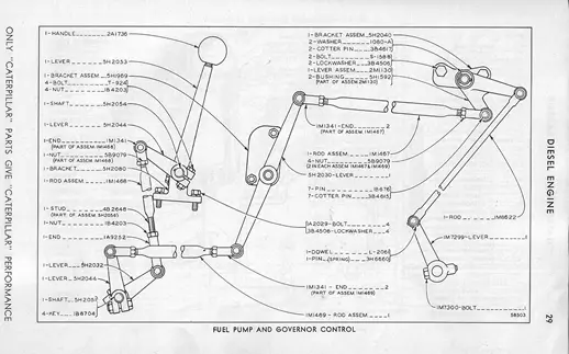

check for lost motion and or interference at each bell-crank. A new 1M7300 bolt should reduce the lost motion that usually causes issues on the D7-8 gov controls--it is hidden way up behind the gov. housing between it and the engine right behind the timing case-- usually caked in dirt, sticks, leaves and oil so can be hard to see if you are familiar with its location.
With suitable socket bar extensions it can be changed although some special language that gentle people should not hear may be required--I am sure I have done a few way back when. May need linkage to be set just right to access the bolt head from memory.
The linkage is set at the factory and to my knowledge there are no dimensions given for each rod length--although the parts diagram may be a good guide for each rod length as they are generally believed to be taken from engineering drawings.
Silly thought for today--check that the 2 brackets shown are installed the correct way up--have encountered such on other machines and trans. and hyd.controls when they did not operate as designed.

I had no idea that that bolt could even be accessed or that it could be a source of play. Maybe it is time to invest in an endoscope and have a look as I am not good at special language. haha
My linkage has no adjustable rods, all fixed length.
