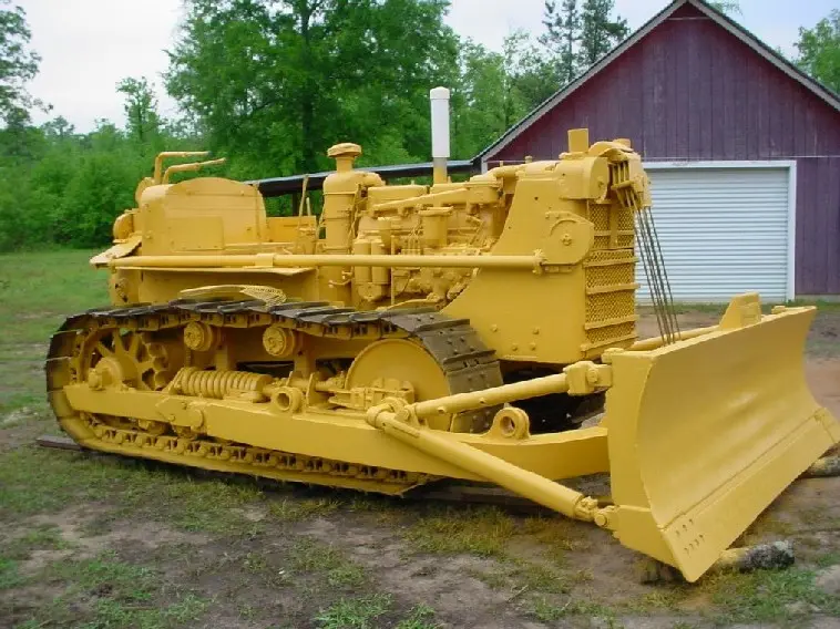

OM,
Its strange that you mentioned that ser.#.
I have 11668. I posted several picks on the old board during resto.
I finished the pond I was working on and she's still running good.
See attached.....

Reply to Stretch:
OM,
See attached.....

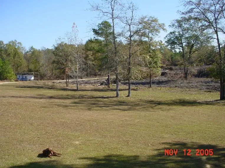

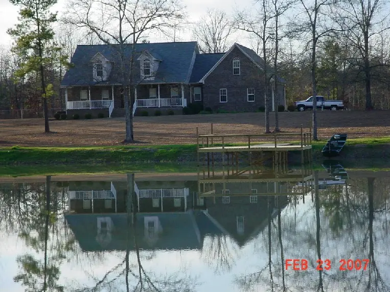

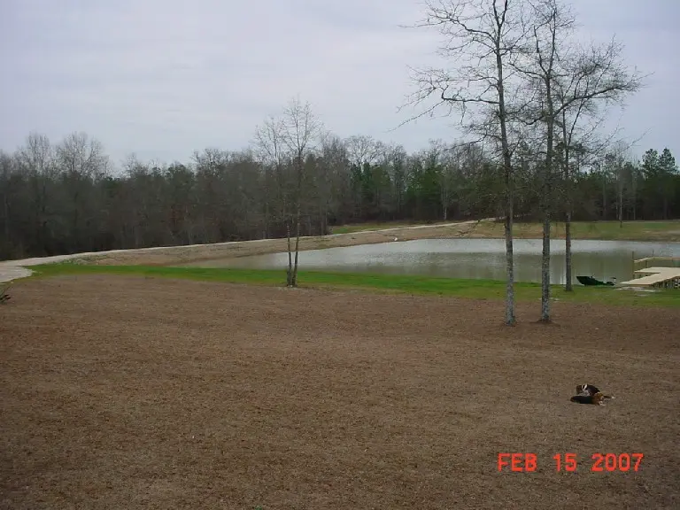

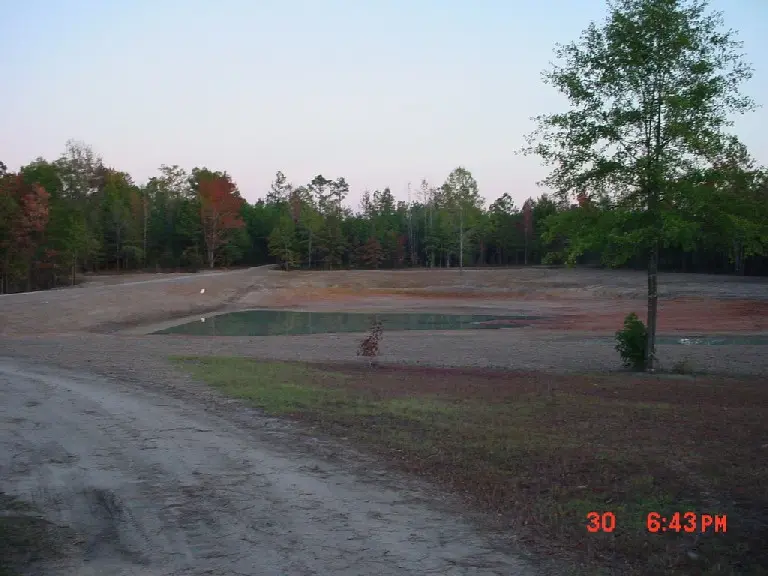

By the way,

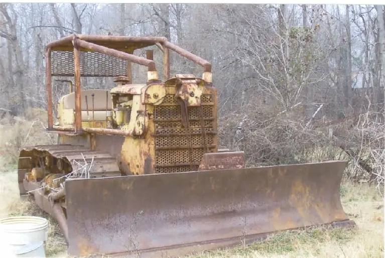

Here are a couple before pics. The Cat and the pond.....
Stretch

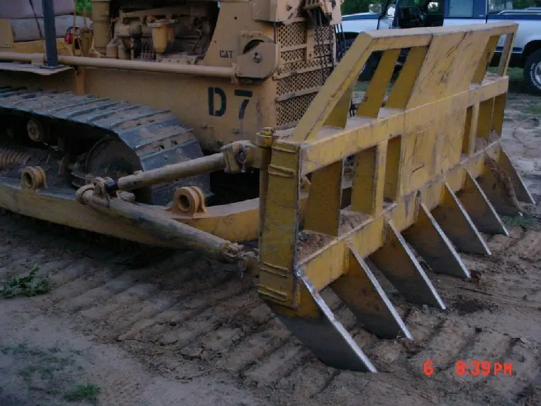

One more with the rake.....
I was also trying to get the signature option to work.
