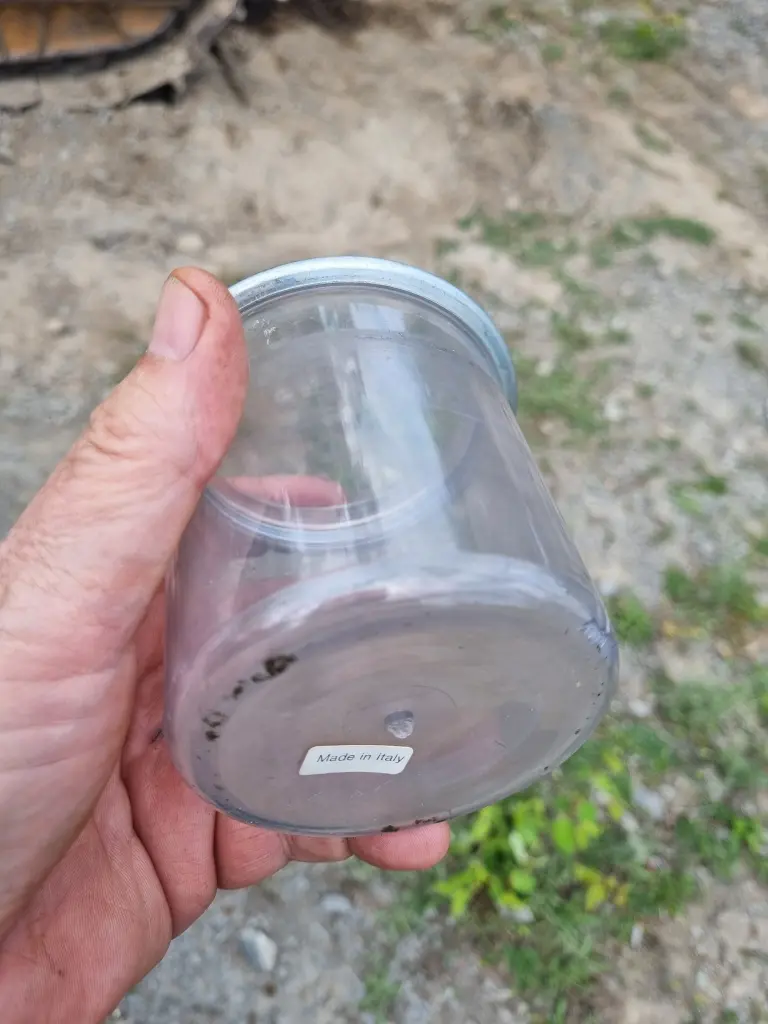

I got my hands on an aftermarket dust cup. It needs the O-Ring, unlike my 3D printed version. My guess is that they place the metal ring in the mold before they inject the plastic. Anybody know the generic size of the o-ring?

Hi Top,
5B3323 is a black O ring (3" id x .188" section) that seals the jar to the pre-cleaner.
