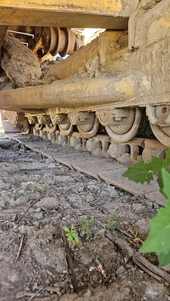

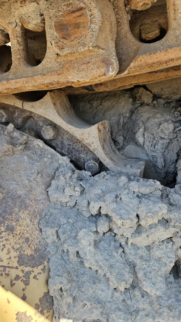

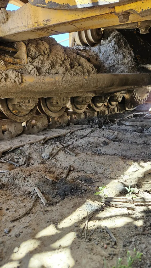

I went and looked at it. Other than the worn out undercarraige the tractor does not look like its in bad shape. The service meter is broken at 999 hours but he said knowing the family that its the 1st undercarraige on it and they probaly parked it when the rollers started to hit the pin bosses. Lived its whole life on a delta island in peat dirt. He wants 8k for it but I might be able to talk down to 7k. Replacement undercarraige is 15.8k for all new salt rails, idlers, sproket segments, bolts and nuts for the pads and sprocket segments and top and bottom rollers.
