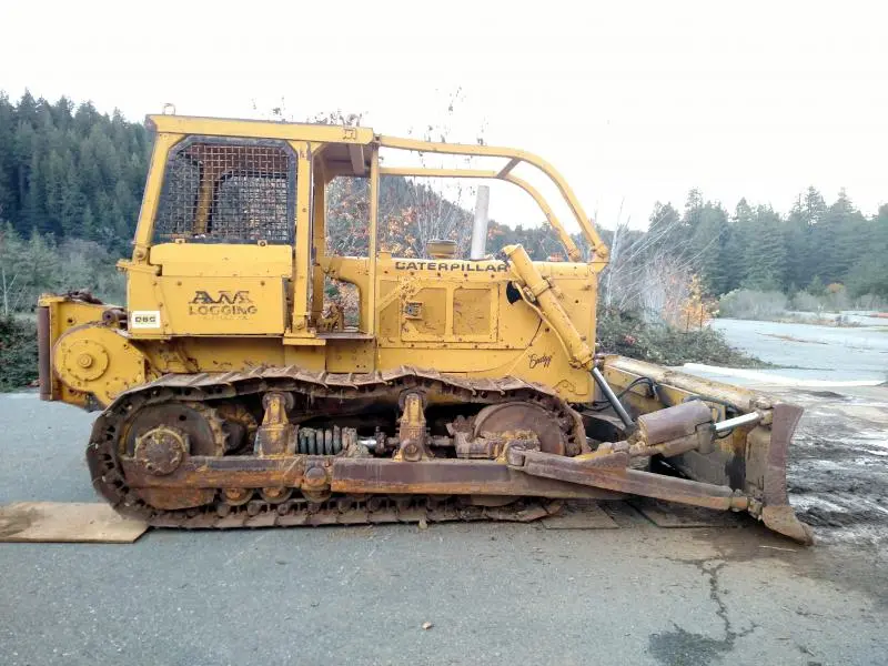

Hi guys, just picked up this jewel. It's a 47j series d6c. The serial tag isn't super definitive so I was wondering where there might be alternative locations. She fired right up after sitting for 7 years[attachment=32277]144867129162438394967.jpg[/attachment]

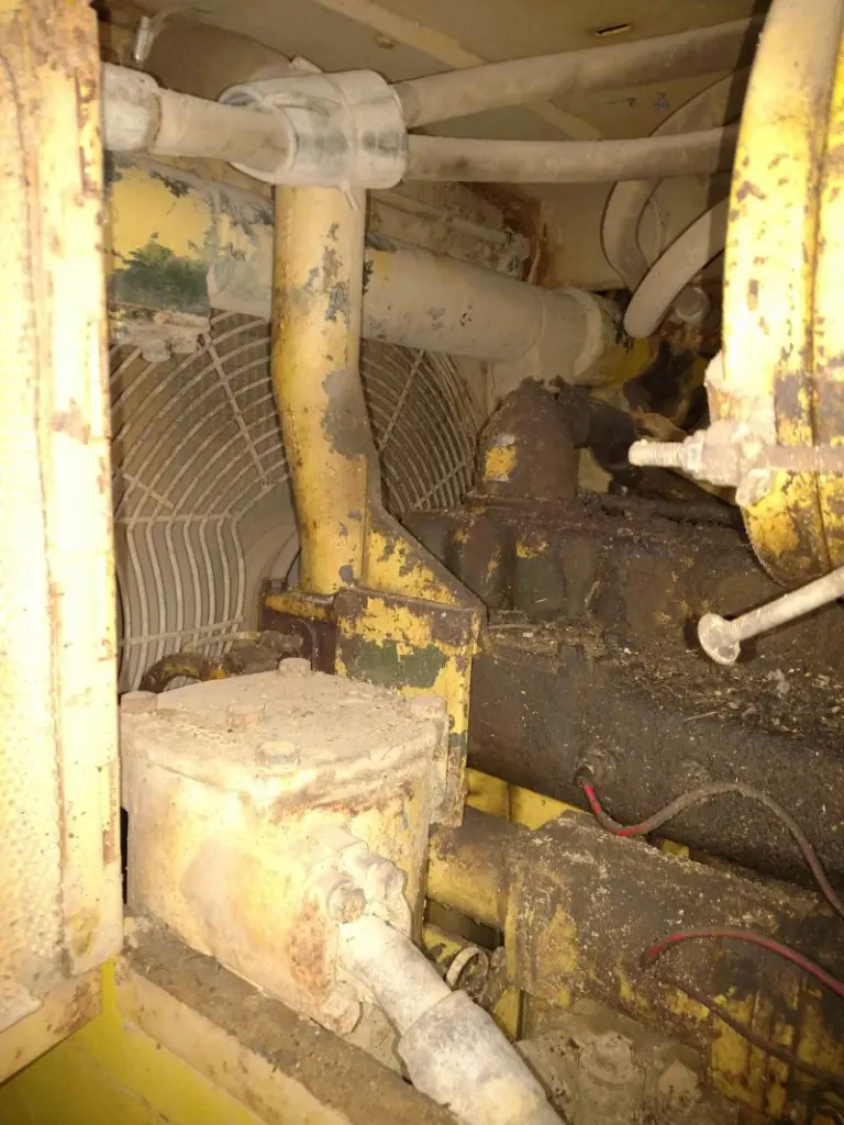

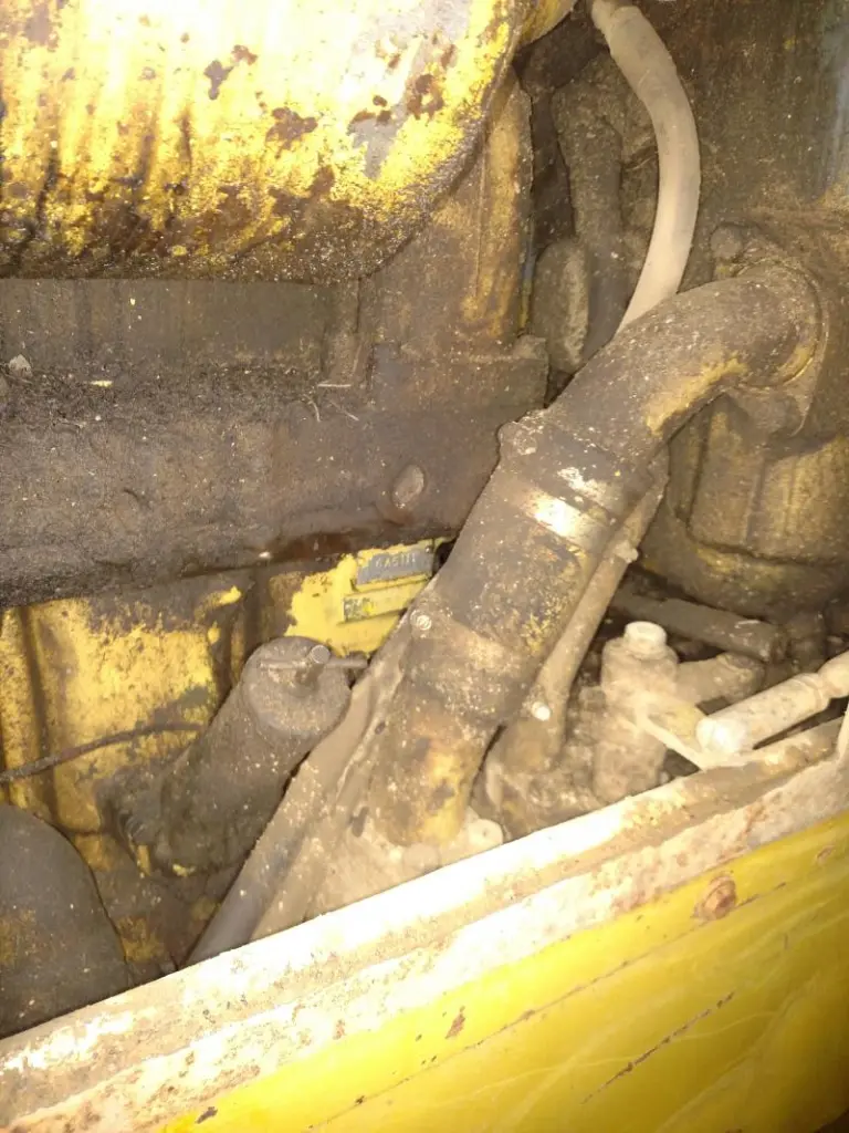

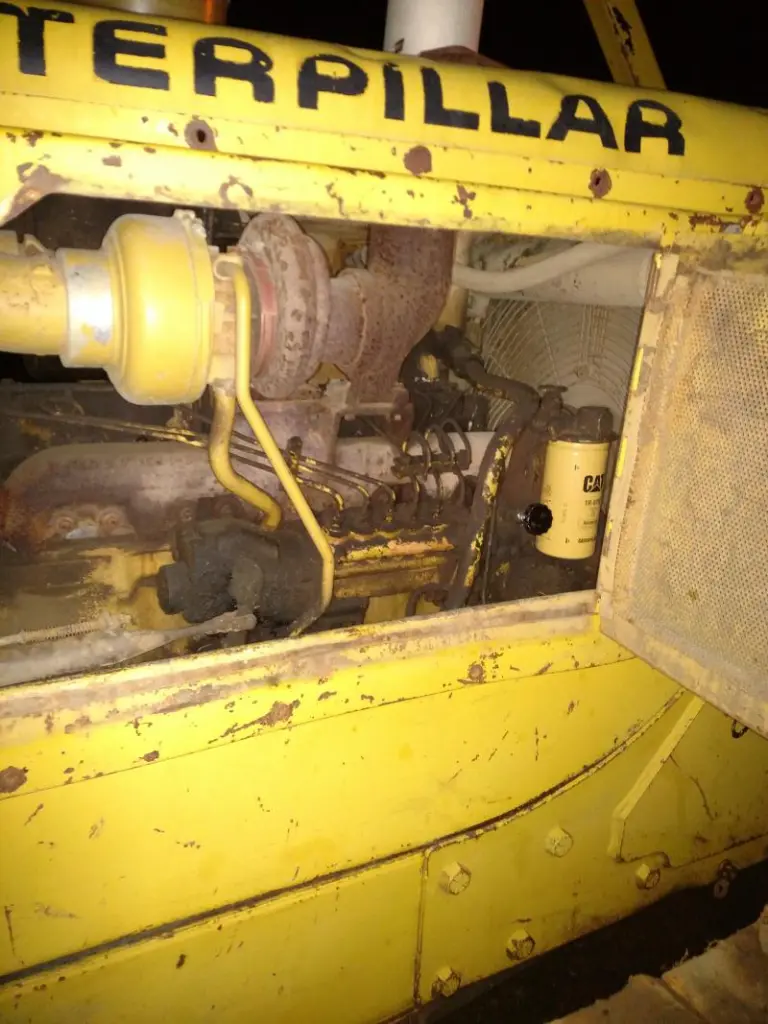

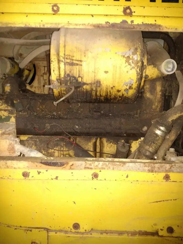

So the dash tag says 47j364... The 4 fades out then it looks like there may have been another number. The engine tag is a cat tag that says 6a5111. Just below that L0192V is stamped into the block.[attachment=32278]1448680454720398481821.jpg[/attachment][attachment=32279]14486805762531487011506.jpg[/attachment][attachment=32280]1448680632052-1407313955.jpg[/attachment][attachment=32281]1448680674555-555794342.jpg[/attachment]
Looks like it's had an engine transplant. Original would be a 49V 3306. The 92V is the designation for a D7G.
Engine arrangement #4N4506.
Engine s/n 3N28255-up
s/n 47J2962 - 3671 would be 1974 production.
Thanks for your help, so its safe to say that's a 3306 in there? I know there aren't many differences between the two, and I can't be positive that the serial is four numbers, not just the three

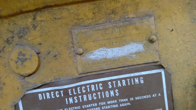

[attachment=32282]IMG_20150722_100220225.jpg[/attachment] here is the dash plate. The one on back does appear to be covered by the winch

Reply to ripvansparky:
That's a 3306 in there now. To be sure, check the water pump, it will be gear driven with a four bolt cover on its front.
I can't read that tag any better either.

That would be a concern, the original was 125hp, the 7G is 200hp.
Question might be was the engine transplant intact or parts swapped from the old engine. I'd guess it would probably be a complete change in tact.
I doubt the D7F engine would go straight in, there are too many differences in the flywheel housing and accessory drives, the plate also doesn't look like a 3306 ID plate which had at least three separate numbers on it, I can't be sure about the fuel system, that looks D333C, the sleeve metering was introduced around the same time as the 3306, but I would need to check the book to be sure. Why is the water temp plugged into the inlet manifold and I wonder how long it was drawing dust through a broken air cleaner indicator before someone plugged the hole with what looks to be a fuel pressure gauge?
There seems to be traces of green paint on it, a whole batch of these were supplied to the British Army in the late '60's. if its one of those, they would be all D333C engines.
