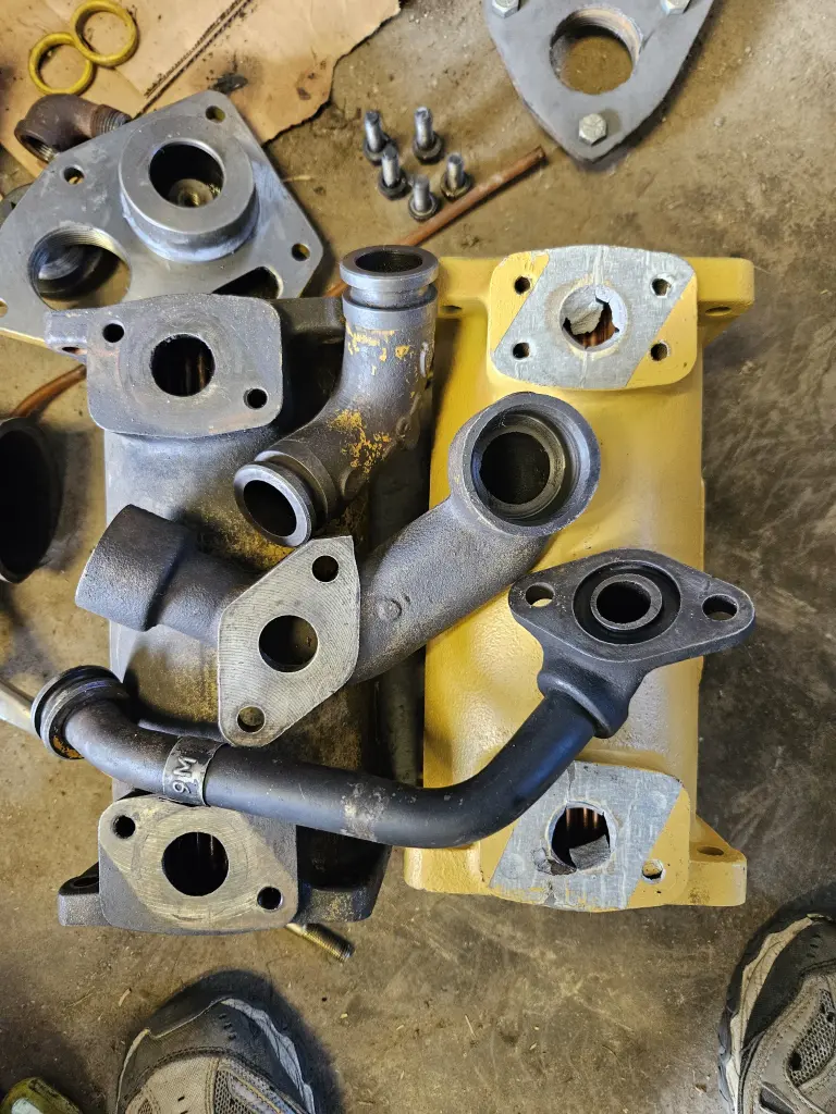

Hi all
I am trying to find a oil cooler for a d6c 74a. My supplier told me that my 5S3413 changes up to a 2W 9978
It doesn't the flanges for the oil lines are different and it has a different bolt pattern and spacing.

I have Googled and called. The part number updates to 7n0098 has 2 bolt flanges. .The images of that part number match mine. Trouble is the 7n0098 up dates to 2w9978 This one has 4 bolt flanges and the bolt spacing will not work with my oil lines.
I'm tempted to screw bolts into the oil cooler and re drill to the correct spacing. I am just concerned about the drill bit walking of center due to the different metals, cast iron and steel.

If you have enough room ( clearances) can you make an adapter (flange) to allow you to use existing holes in the components? Sometimes the simple "farmer's" fixes allow dis-similar units to be fitted without loss of function. -- cts

I don't think a adapter is a good idea as the other end of what bolts to the cooler is a pipe with a oring that press into a fitting.
Everything has to be reasonably close.

are the fittings sae code 61.https://www.tompkinsind.ca/wp-content/uploads/2024/02/tompkins-technical-section-code-61-62-flanges.pdf
the older code 61 have 2 bolt clamps the modern day cat flanges are heavier. and require a spacer ring if using aftermarket hose ends with genuine clamps

Thu, Jul 9, 2026 6:56 PM
bcguide
Send a private message to bcguide
Posts: 78
A picture for all you inquiring minds.
I have found a used one but the cost is within 200 of new
Thu, Jul 9, 2026 6:58 PM
