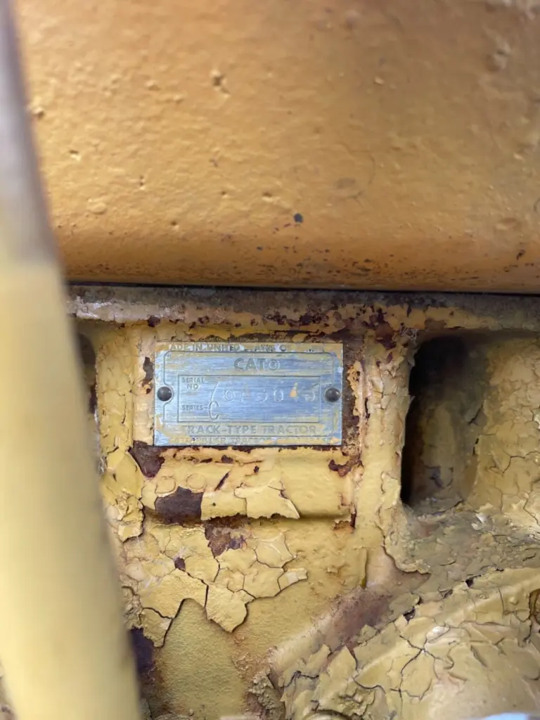

 [attachment=67242]F8CB8305-3112-4C43-A409-A9BBC2EB1164.jpeg[/attachment]
Does anyone have any info on this machine and engine?
thx  [attachment=67242]F8CB8305-3112-4C43-A409-A9BBC2EB1164.jpeg[/attachment]

+The only thing I can come up with is the D6C 76A00001 approx shipping date was 1963
76A00001 US D6C Equivalent Serial Numbers
73A00001 AU
83A00001 UK 1964 approx shipping date
96A00001 Japan

It’s a start
Thank you Sir

It’s hard too make out looks like
76a3643
76a3643
D6C 76A3643 has a D333T (turbocharged) engine and a powershift transmission. The D333T might work in your D6B but would be higher horsepower. Old Magnet or others on this site should have more information. The D6C 76A is a good machine overall.
