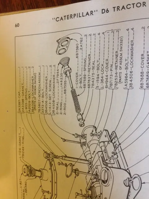

New to the forum and look forward to your experience with the old cat's. Had the good fortune of acquiring a 61-62 D6B in great condition. The only issue is left side steering clutch is non-operative. Right side clutch and both brakes are working fine. The clutch engagement pull force on the levers is noticibly different from right left, with left being maybe 1/3 force to pull back and engage. Also, the machine was re-painted 3-5 years ago and on the left side clutch rod (under seat) that goes into hydraulic unit there is lubricant residue that can collected dirt/dust where right side is total clean. Seems to me like one of these seals in the hydraulic control mechansim is not holding and leaking back onto the rod. Just obtained the machine and still need to check all normal items like lever free movement, clutch compartment fluid, etc. Hoping someone can help narrow my troubleshooting based on the symptoms. Maybe the rod seal item 7B4375 in attached is good place to start?
[attachment=23848]Hydraulic control unit.JPG[/attachment]

Yes, the 7B4375 seal is leaking. It's a bit of a job to get at the seal, requires drilling out the retaining pins for the seal holder
(aluminum) and making a pulling tool out of all thread and a coupler (7/8-14tpi).
I can post some pictures when you are ready, usually involves pulling the booster and replacing the booster pump seals while your in there.
