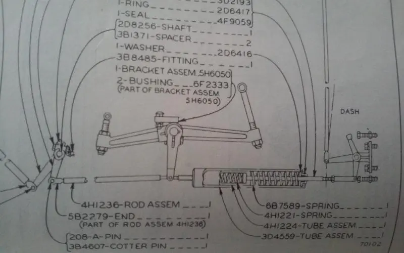

Parts pages from the grader......
Seems to me this is more appropriately termed a foot throttle with a hand throttle added on since wherever the hand throttle is set the operator can either increase or decrease rpm if he pushes the pedal hard enough. As soon as the foot pedal is released, the governor setting returns to where the hand throttle is set.
A decelerator would have authority only to decrease rpm and could be done more simply with two levers on the same shaft. The one linked to the hand throttle pivots on the shaft. The other is fastened solidly to the shaft and is pulled to slow by the decelerator pedal and returned to fast by a spring. The hand throttle would act as a stop to set maximum rpm including being reduced to fuel cutoff to stop the engine. The spring would have to be strong enough to get the governor control over the fuel cutoff detent since neither the hand throttle or the decelerator has any direct linkage to move the throttle to fast. The decelerator pedal would probably would wind up being quite stiff.
