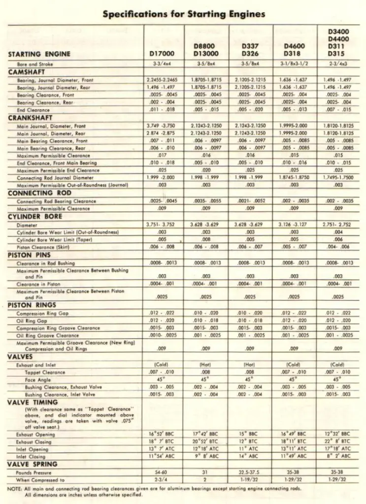

Here's a pony specs page for the dimensions.
