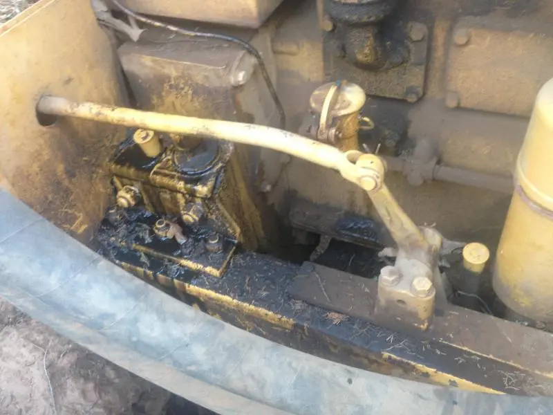

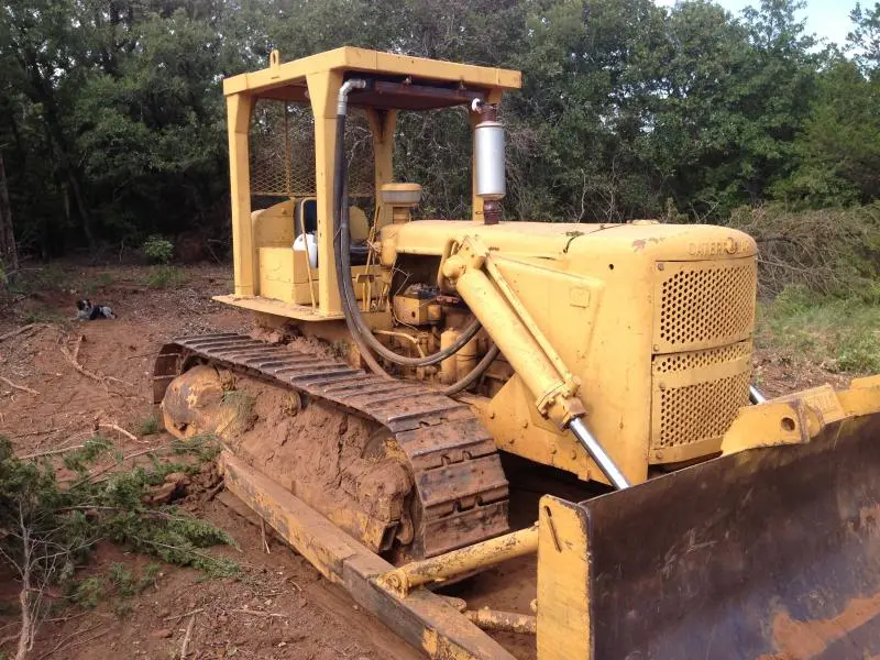

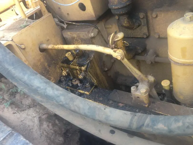

so i bought a d69u ran it for a day and started to notice a problem. first started when i ran it, it was getting hot so i shut it down for a few hours, came back checked the oil and noticed none on the dip stick. got 2 gallons of oil and to my amazement it took all of it. filled it while it was running to the full level on dip stick. started ruiing it a little and noticed oil coming out ofa differnt dip stick. im not sure what the other dip stick is to the left or the engine oil dip stick. is it the oil clutch? in any case the engine ils is draining as soon as i start this thing to the area to the left. almost instantly it will drain whatever i put in and if i pull the dip stick on the left it will come running out. anyone know what might cause this? serial number is 9u24459
[attachment=30499]IMG_2091.jpg[/attachment][attachment=30500]IMG_2129.jpg[/attachment][attachment=30501]IMG_2130.jpg[/attachment]

Welcome to the forum. I believe that is the oil clutch dip stick. Should be one higher up for the pony motor. I'm sure someone will chime in with why it is pushing engine oil to the oil clutch. Is this your first Cat? If so there are some do's and don'ts on starting with pony and proper shutdown of pony along with many other operating do's to keep your machine healthy and working. Will not get into great detail until we hear more about your level. If you have books read them. If not get an operators manual and read it to save you a ton of money.
Edit: On another look at the pictures it looks like the pony has been removed and it is converted to direct start. Must be late.
