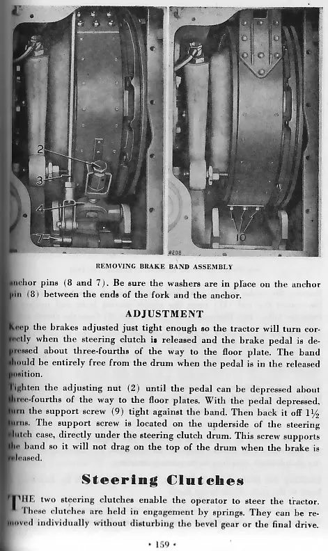

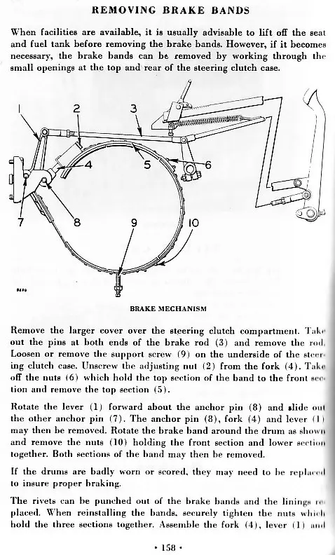

Hi Team,
scans from the Servicemen's Reference Manual should help, sorry I do not have a Form No for this one.
