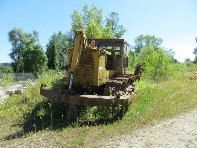

[attachment=30902]IMG_0267.JPG[/attachment]
Hello , you will not be the first one who converted into hydraulics . This Italian contractor converted his D9 of the first series into hydraulics . The first D9D was only available with cable control .
Make sure that the ram may not be exposed to lateral forces .
Good luck , johan7
