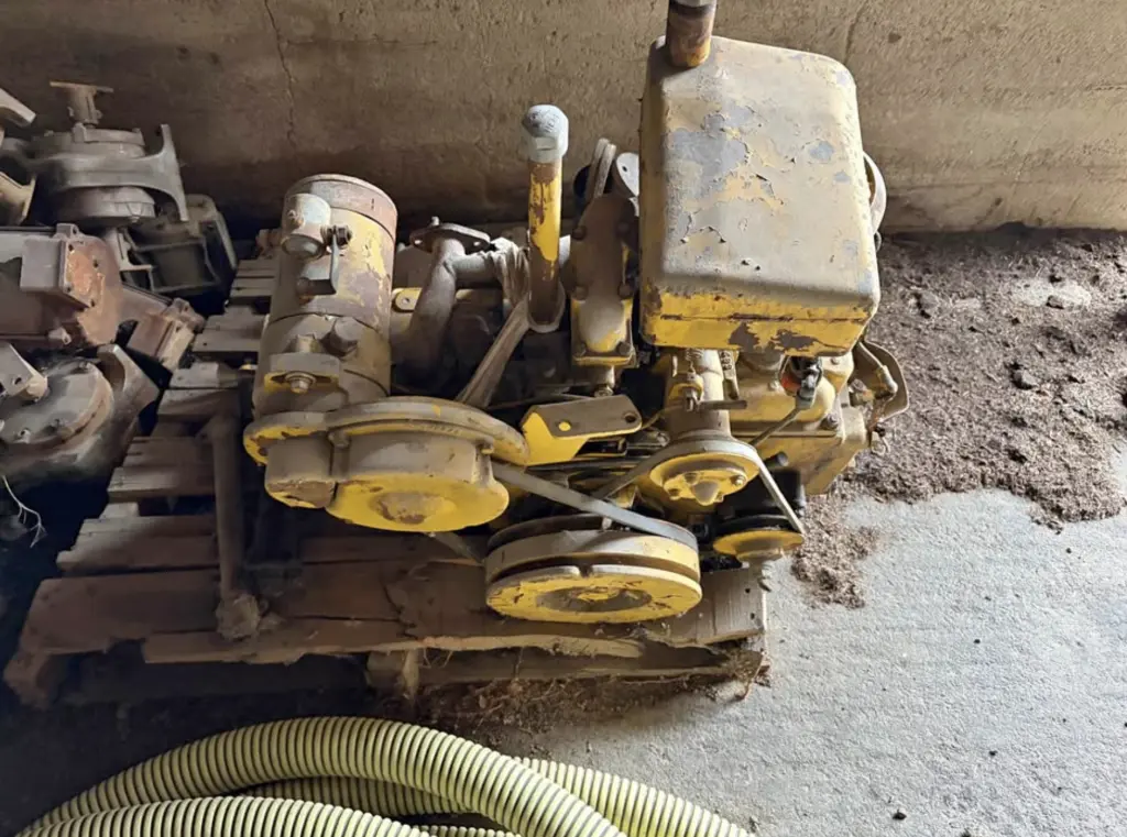

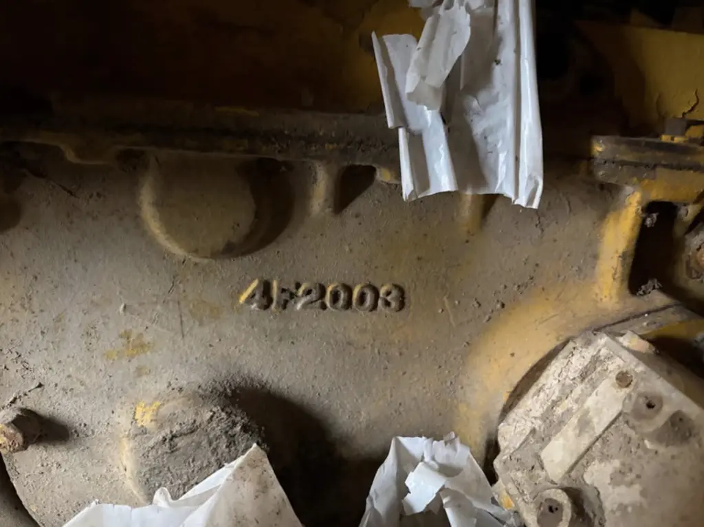

Hello
I have a D2 5U with a pony motor that is past its prime. Recently, a running pony motor off of a d318 power unit was posted on FB marketplace in my area. I didn't think a pony off of a bigger engine like that would share any similarities with the pony on my D2 but the pictures have me wondering. Is there any chance I could make this pony work on my machine? Figured I'd ask the experts.

there nothing in common between a d2 pony and D6. Not adaptable.

I am not an expert, but as Brian18a said, nothing compatible. There are some early J series pony motors here on the West Coast that you could adapt to a U series (so I am told). Sad part is that a pony motor can get expensive to overhaul. Good luck. JM

J and U series pony motors are swappable. You just need to swap some of the external components from one to the other. Things like the exhaust manifold etc. can be different but they'll bolt right on to the other engine. These engines are very simple so if you felt comfortable with a lawnmower engine, you're not far off handling one of these. If your 5J crank float is within limits, has good compression (for a pony, bugger-all compression is still good : ), then just swap the external components. You'd only swap the carburettor and magneto if the 5U items weren't in good shape. Otherwise you don't need to swap them. Another option is to redo the main bearings to reduce the end play. For that, all you need to do is buy a new pair of dowels, then rotate the main bearings and bring them inwards to reduce end float (crank must be centered axially between the two cylinder bores), and drill a new pair of dowel holes. Some new gaskets and you're back in business. That way you'll have a good spare pony sitting on the shelf. If you start with figuring out what the 5J pony needs, get it ready to fit, then just swap the whole thing over and re-up the pinion, you won't be down for long. Then you can do up the 5U at your leisure.

The d6 and d4-2 pony motor parts are not interchangable and am still have 2 set main bearings 4f9416 - 020
