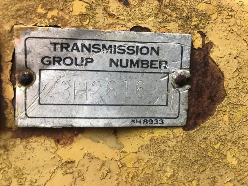

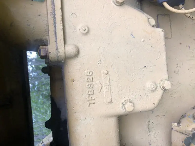

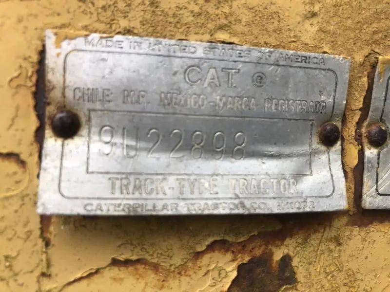

My father in law passed away last year and Iโ€™m currently working on getting this machine running again (should be running and operational within a week or two). I have been unsuccessful trying to determine what year this machine is. Closest I can guess is 1956-1957. I will be selling for my mother in law and need to try and do the best I can for her. Iโ€™m seeing values between $1500-$15000 and have no idea where to start for fair market value.
[attachment=55246]44594386-2C0D-423E-AE27-A7256C54D637.jpg[/attachment][attachment=55246]44594386-2C0D-423E-AE27-A7256C54D637.jpg[/attachment]
I appreciate any insight and help anyone here can provide.[attachment=55247]C5290636-53A0-4A27-857C-9DDBD6B31767.jpg[/attachment][attachment=55248]D4010555-3A0C-400A-8843-B1DDD6DE84D2.jpg[/attachment]

The D6 is a 1956 year. Numbers are 21301 to 24049 so that would be pretty close to mid year. catskinner
You have found the value range. The first 3 pictures with the numbers are the important ones,casting numbers don't tell much and don't match parts numbers very often.

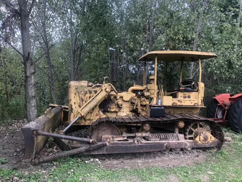

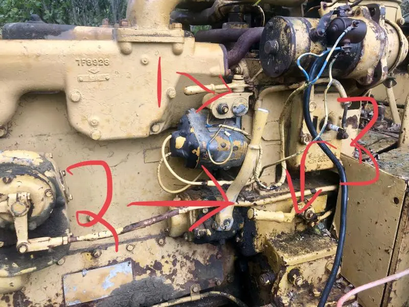

We got the pony motor running today. Then realized we didnโ€™t have two key pieces of information - how to engage and start the diesel engine and how to shut it off if it did start. ๐Ÿ˜‰.
Hopefully the pics post. The first shows the pony motor area with what I think are the three key levers. I think the first horizontal lever floats the valves so the diesel can spin up and build oil pressure. I think lever 2 engages the pony to the diesel but I donโ€™t know what lever three does. It has linkage that runs toward the back but I donโ€™t know to what.

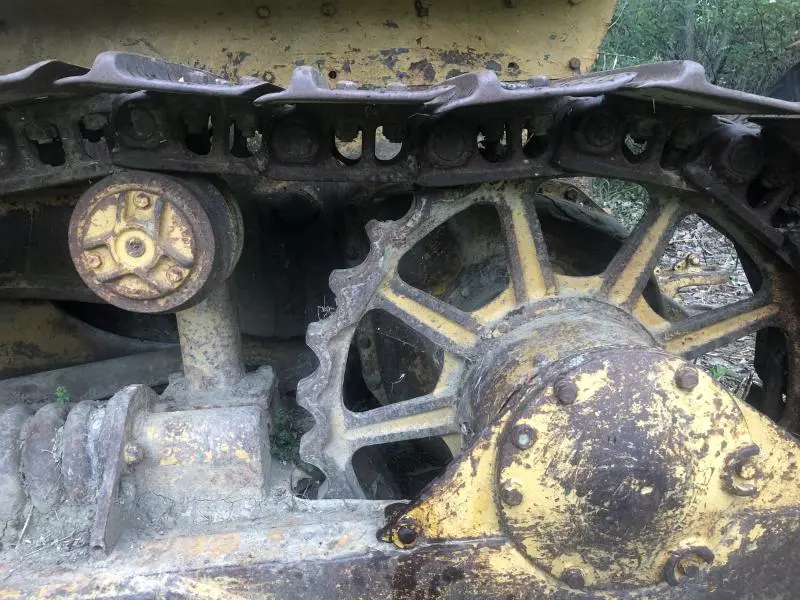

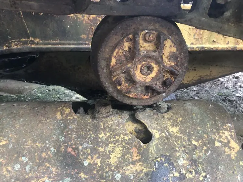

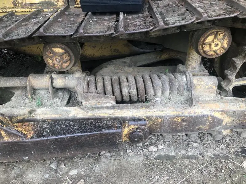

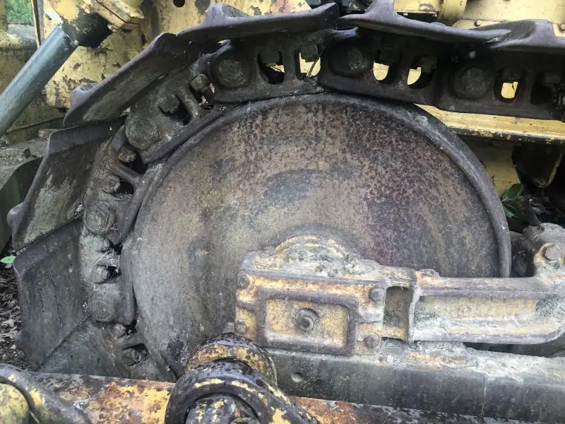

Also attached are other pics. I donโ€™t know exactly what to show to indicate the undercarriage condition. [attachment=55303]00CD9D10-E1BF-4DD3-8B9B-8E3E888268D3.jpg[/attachment][attachment=55304]A8F0B09E-A715-4C9E-B69F-DC7059B84EAD.jpg[/attachment][attachment=55305]C34C967A-CA95-4292-A083-08048287C1A6.jpg[/attachment][attachment=55306]780B1C6D-2A31-4DB9-82A5-F838447986B1.jpg[/attachment][attachment=55307]D2EC2A93-36EB-40CB-9A98-210E5EA7EF6E.jpg[/attachment][attachment=55308]2C442D18-F628-4E07-B678-FC95BB9FC432.jpg[/attachment]

lever i is the diesel engine decompression lever
lever 2 is the pinion clutch lever--forward engages it to spin the pinion and spin the diesel, to the rear brakes the pinion to stop it from spinning so you can engage it to the flywheel without grinding
lever 3 actually pulls the pinion gear in to engage the flywheel, it will auto disengage when the diesel starts
sprockets are a bit worn but will last a while-
the grousers are worn down
but easy fix to weld on new grouser plates
the idler appears to be a bit forward from adjusting slack out of the tracks--a symton of worn pins and bushings--check them to see if they have worn thru

i am an hour east of albany
to start diesel
shut off throttle completely
pull decompression lever
start pony
engage pony and spin diesel
check oil pressure on diesel
close decompression lever
let run a few minutes to warm up diesel intake manifold
open diesel throttle
shut pony off by turning off gas valve and let run out of gas

To shut off the diesel engine just throttle the engine all the way down. You'll feel a spot where the lever stops, push it past that and it should shut off. Before you start it again don't forget to throttle it back up past the stop or else you're not going to anywhere.
I should add make sure the pony gas shutoff valve is in working order before starting. I was just working on a grader a couple weeks ago and had to take the valve apart to get it to open or close.
As for a value, I would put that in the 3500 range as long as it runs. Of course, I say keep it, but I like a good D6.

Hi,
link to D2 D4 starting procedure thanks again to Toby.
D6 is similar.
