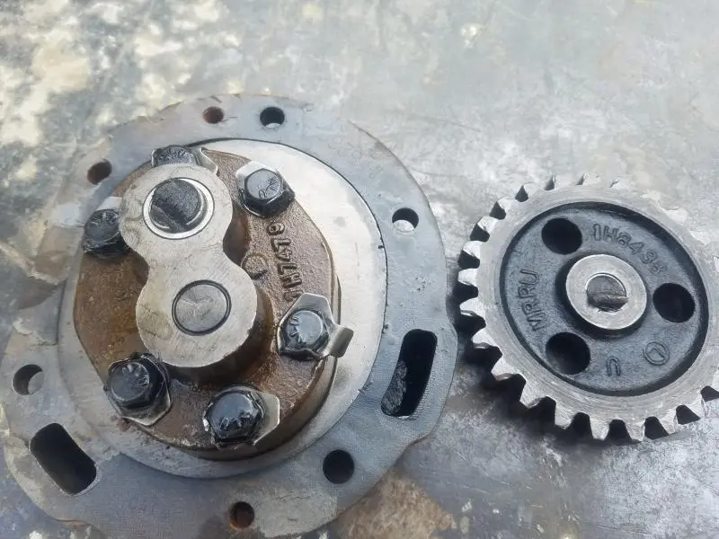

I adjusted my clutch today after I abused it pushing a big tree over. It was really hot... after adjusting it I started it with the cover off and I couldn't see any oil flowing. Should I be able to tell that the oil pump is working? It doesn't want to snap in right and pops out. I rebuilt the pump when i had the bell housing off. Probably only got about 10hrs on it so far. Any ideas?
Thanks Jesse

Yes I did have the clutch out and apart. The pump was in bad shape. I put new pump gears and shaft in it at that time. I don't remember a drive pin. There is woodrof keys on the gears and there all new.

Well I found why I had no oil now I have to figure why a new 4140 shaft broke. The bigger drive gear that turns the pump gear is a little rough and has funny wear pattern from previous damage. Do you think that would cause the broken shaft?
Thanks Jesse
Thanks Jesse
I doubt a rough pump gear would cause that.
Pump shafts have been known to get bent and eventually break if the pump is installed on the cover when maneuvering the clutch and housing assembly in to place and the gear gets bumped. Recommended procedure is to install the pump after the assembly is installed.
agree with OM.
That is a static bending fracture most likely either from having the pump installed on the clutch housing before installing same or pump drive teeth were not aligned/engaged before tightening the pump mount bolts.
As OM said fit the clutch assembly and main housing then install the pump last being sure teeth engage and that the pump goes on the dowels by hand, and squarely sitting against its mount faace, before tightening any bolts up. Check for pump gear tooth clearance as you are doing up said pump mount bolts.
