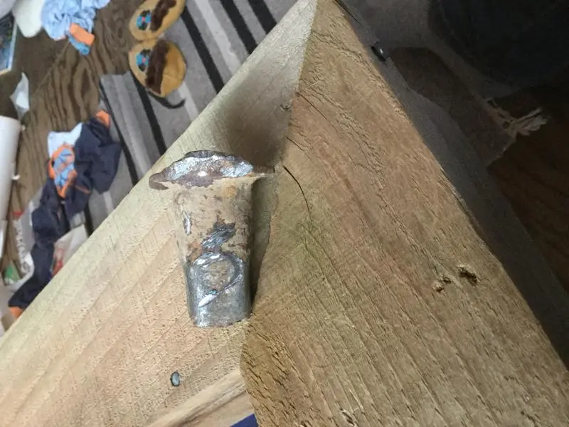

Well, here they are. Not the nicest machining in the world, but I'm hoping it'll do the trick. I took pieces of stainless pipe (it was the closest thing I had to the right diameter) and welded little stainless washers on that I had cut out with a hole saw. Then I got em down to the right size (hopefully!) and now I'm going to hold the leather washers into the cup with a tincey amount of blue gasket compound. I am also going to put a little bit of gasket compound on the top of the valve guide in case these guys expand when they heat up. Once they are in place, I'm going to fill the little lip, between the cup and the leather washer, with oil and let it soak in for a day or two, hoping that the leather will swell and make a tighter fit. Another thing I have done while the valve springs were off, was turn the valves back and forth. I did this with a slow drill on the stem, two at a time, while I had the air compressor hooked up to that particular cylinder. It would turn very easily for about three times back and forth, with a sandy grinding noise. Then all of a sudden it would get very hard to turn and make a metal on metal squealing noise, at which point I would stop right away. My theory is the sandy grinding noise is burnt on ash deposits coming off and then I'm back to valve on seat contact. Do you guys think that might be correct? I am very excited to start her back up and see the results. Robyn
Seems like the long way round for not replacing valve guides and possibly worn valve stems. If the guides are that worn I'd expect the loose fit would knock out those seals in short order. That okie valve seating process doesn't do anything about proper valve seating if valves and seats are pitted/worn. Your just knocking off the crud.
It is definitely a band aid fix. When I have some money to put into it, my plan is to properly do the head and the liners at the same time. One of the cylinders has pretty bad blow by, the compressor (it's a little dewalt one) didn't cycle off it just had to stay running. In a perfect world, I would find another head to have redone and have all of the liner parts and accosiated gaskets on hand before tear down.
