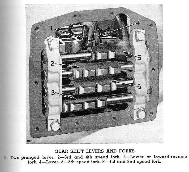

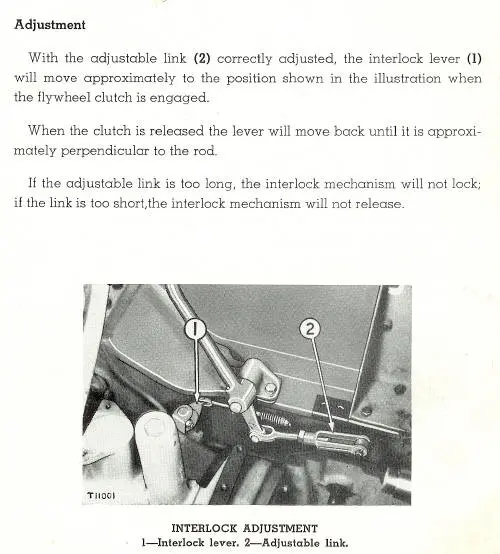

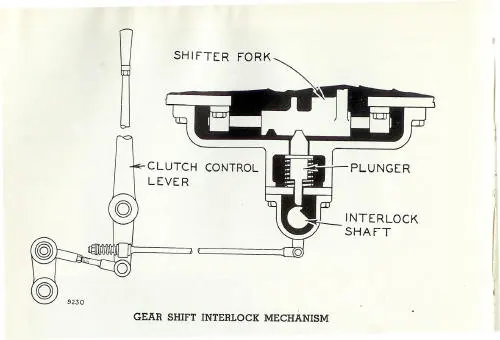

With a broken plunger one of the shift forks may be out of position. Get everything in neutral and check the interlock adjustment. Not likely the problem is beyond the shift mechanism though anything is possible.
 [attachment=70883]9U-Shift-Levers-&-Forks.jpg[/attachment]
 [attachment=70884]Interlock #1.jpg[/attachment]
 [attachment=70885]Interlock #2.jpg[/attachment]

Thank you sir very much. The number 5 and 6 in the picture above is stuck in the center and won’t move. When I try to move one or the other they Both try to move but won’t.
