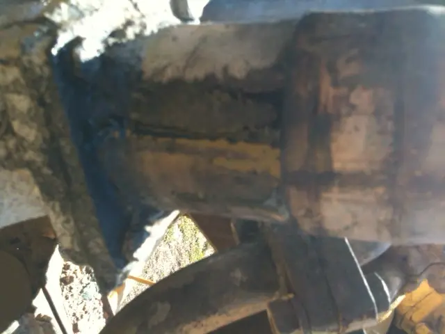

markpa13
Send a private message to markpa13
Posts: 15
Reply to 8k bill:
markpa13, make sure the injection lines are in the right order on the pump. hade an 8 do the same thing.👋
I played with her again today, kept repeating the process for bleeding the lines and gave it a shot of ether, and it actually fired. I continued to bleed some lines while it was running and the motor seems to run smoothly. However, it is throwing a lot of white smoke and I'm even getting some oily liquid coming down the exhaust stack (condensation?). The antifreeze levels did not drop overnight, so I'm not sure if it is coolant getting in. I let it run for about 30 mins to operating temperature and it did not seem to go away. Everything is new in it, so I doubt the head gasket is blown. I included some pics. Any advice...
[attachment=16523]exhaust.jpg[/attachment][attachment=16524]smoke.jpg[/attachment]
