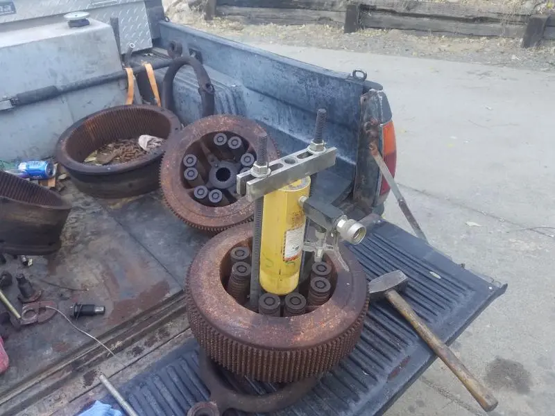

Hey guys I'm trying to find what the thickness of a new stack of disc's is. I found a replacement spec of 2 15/16 but can't find what new is.

3-5/16" new is what my chart shows.

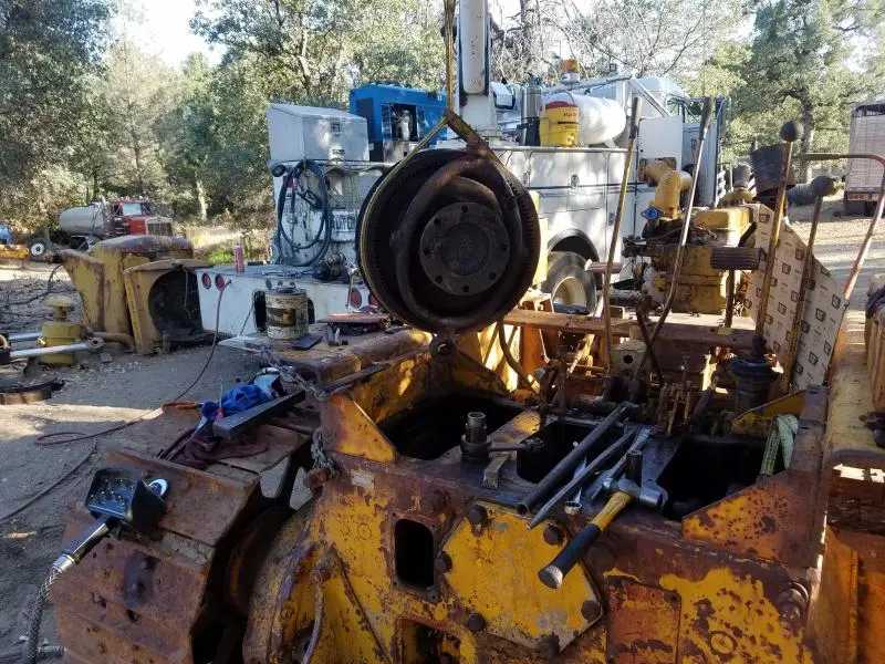

This tractor has been sitting for close to 30 years so it's been a challenge getting it all apart. I have got 1 clutch tore down and cleaned up and I get a measurement of 3 3/16. So unless the other side is in different shape I think I'm going to run them. Good to know you can be creative with them though.

I don't know for sure but I think that vermin piss is very corrosive. So far the the worst plates just have a little friction material missing around the edges.
