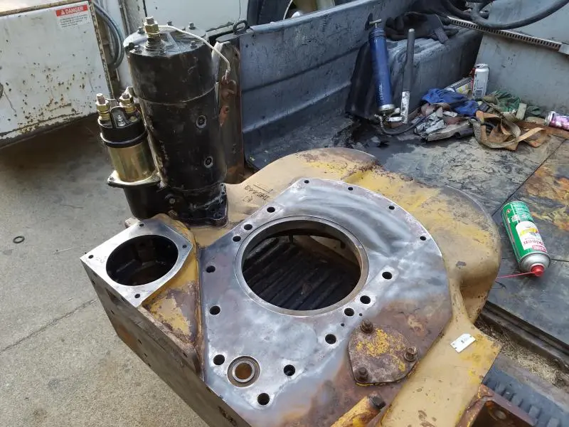

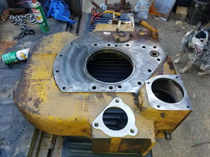

I'll have to dig out my notes for the measurements. I fired it for the first time Monday. The starter ran nice and smooth. Had to grind a relief for the one nose cone bolt. Other than that it fit great.

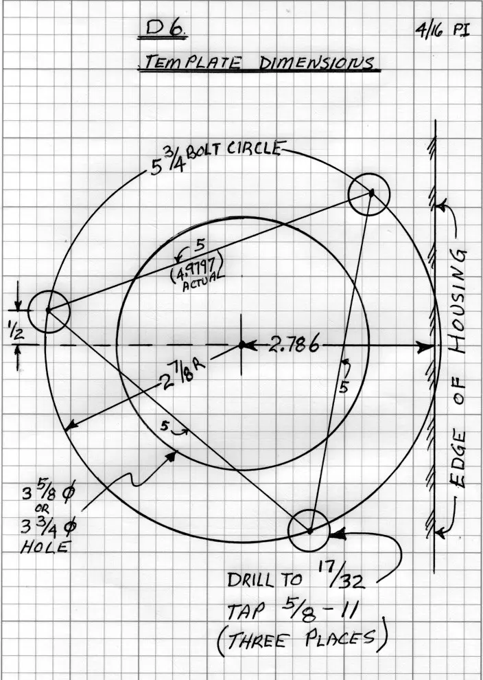

OM, I got this diagram off of your Web site. The only thing I did different was 1/2" measurement to the 1st bolt hole off Center line. I found a post here that said to use a different measurement. And that made the holes line up on the casting perfect.
Thanks Jesse
Thanks Jesse
Thanks for verifying the template. Can you tell how well the flywheel engagement fit? Amount of back lash, loose or tight?
Did you bore for 3-5/8" or the 3-3/4"?
I bored it 3and 5/8. I have a short video of it engaging and spinning before I put the clutch to gather put I can't figure out how to post it. It looked perfect to me but I didn't measure the back lash.

Did you use this dimension for vertical location of the starter hole?
