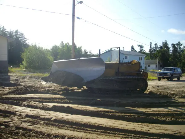

if it is just a hobby machine just put the head back on using lots of avation gasket goo and you should be good.
on one of my cats known as THE HOOD, he had pitts in the pistons from being under water for 3 years.
http://kingofobsolete.ca/d6_9u_the_hood_part_2_webpage.htm
THE HOOD ran good the other night plowing dirt after fixing a water break. not bad for a winter freighting cat, LOL
