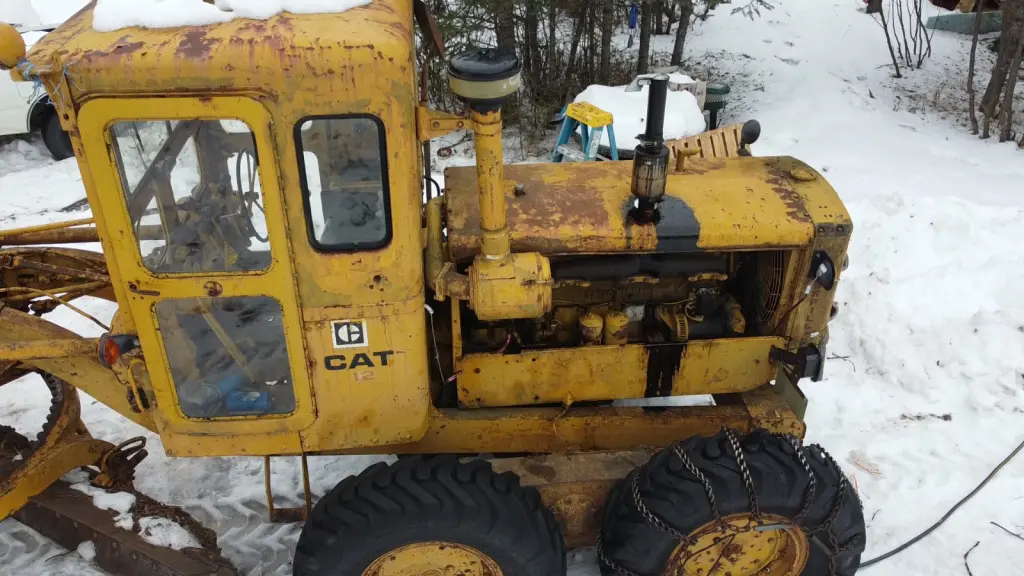

I have a 1950 D69U that I’m working on. When I run it oil blows out the exhaust. Any thoughts on what it could be?? Thank you in advance!!

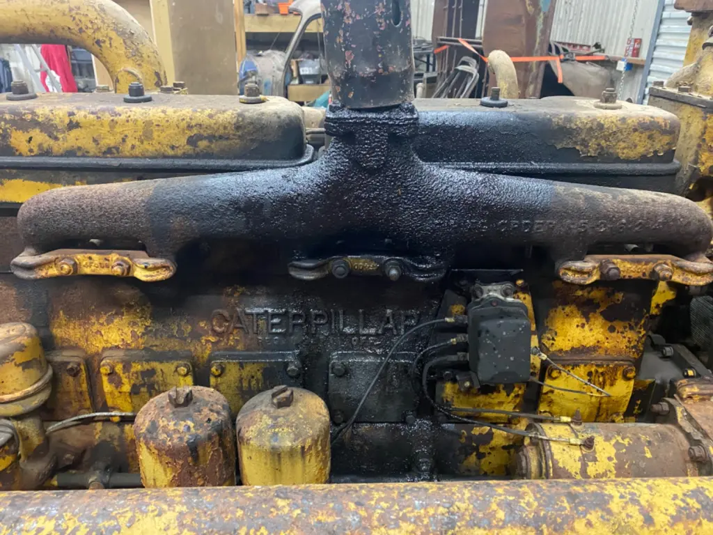

Yeah a good four to eight hour shift at full load would help to clean the 'Slobbering' out. Keep an eye on the temp ... if it don't want to come up to temp check your thermostats are closing all the way. That carbon infused oil I removed with oven cleaner, lye, and drain cleaner and let it set over night at 25ish°F. Then pressure wash with hot water.
 [attachment=70987]KI5684ment.jpg[/attachment]
These old rigs were made to run. Letting them set for long periods of time is not all that good on them. Things inside get tarnished like the cylinder walls and the rings will most likely lose their seat. One reason for it slobbering is the rings my need reseated. That is why once you get it up to temp you need to reseat the rings by running the puppy water out of it.
