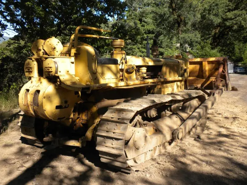

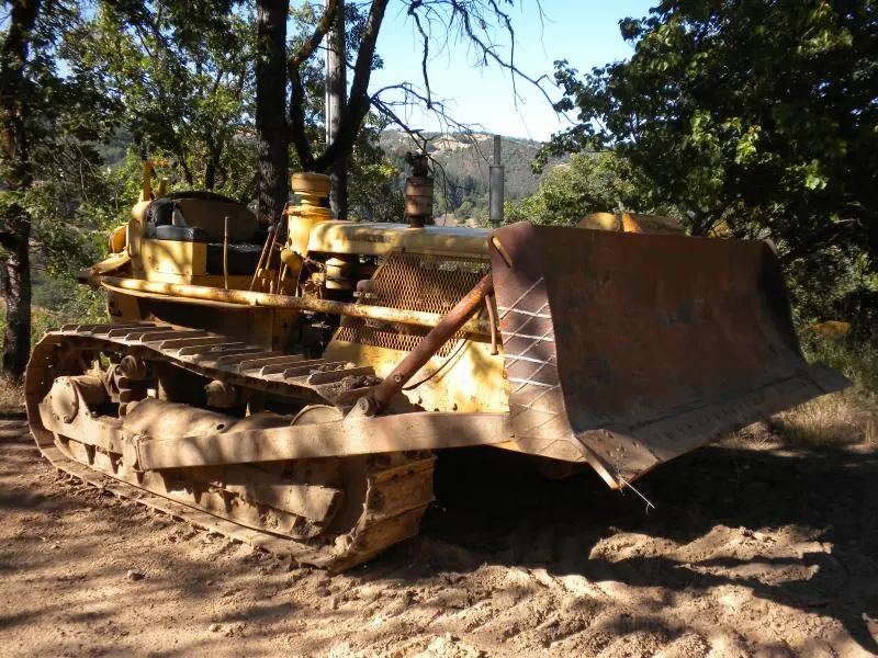

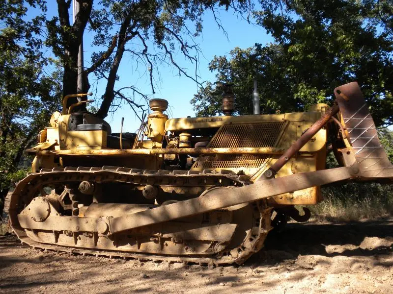

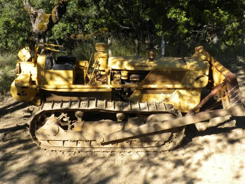

Hi Everyone - can someone out there translate my D6 9U serial number: 4378SP into a model year? Also, I recall reading once (but cannot find the reference anymore) about the SP suffix having reference to special attachment - do you have any information on that piece too (I cannot image what it could be as this CAT is very sparse from a features point of view). My crawler is a barebone cable cat with a wrap-around pull-start pony motor for the diesel. It loves to run but it certainly does lack all the bells and whistles. Thanks (pics attached)

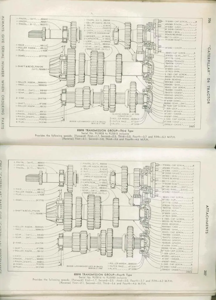

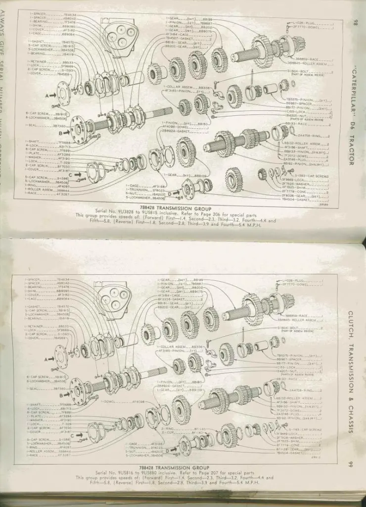

Good information - thanks all. Using this info, I checked the manual I have and found what is likely what several of you are referring to (attached). There's no easy way for me to verify it, but it certainly makes a lot more sense now. Happy 4th of July...
I added thumbnails too so there's no need to download the PDF doc
