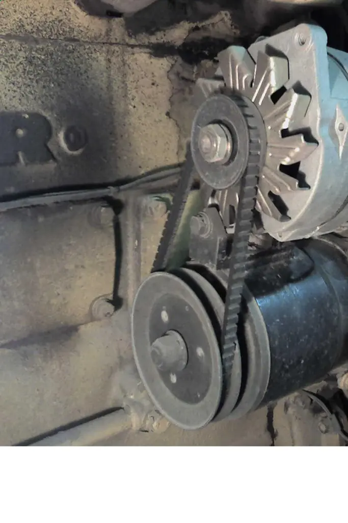

Posts: 946
old magnet, i see i have missed the boat on these simple alt conversion for the d6 9u. i put a pulley on the fan and mounted an alt above the generator.please tell me more on the simple version with a GM one wire alt.
thansk
KoO
Published Author
Wed, Mar 25, 2009 8:51 PM
King of Obsolete
Posts: 946
here is what i'm running so have a good laugh. 5 years ago i got the idea from the old BB but i use the same belt i use on my IH cats so everything is the same. started off with an aluminum pulley and after about one a year i gave up and found steel pulleys work the best. but finding a big steel pulley in the great white north is getting harder and hard so this is what came when i told the guy over the phone. i guess when you are 1200 kms away big is not that big, LOL.

I purchased a "conversion kit" from Assocated Tractor Service in Stockton CA about a dozen years ago. The kit included the alternator and the bracket that attached directly to the engine; a very "clean" look. I don't recall the cost but it has worked great for many years.
Hi Delta KJ,
I suspect that is one of the American International Manufacturing units as they have been servicing the west coast for many years.
Sat, Mar 28, 2009 7:43 AM

Hopefully a photograph of my alternator "kit" is attached. As you can see, the alternator faces the rear of the tractor.
that is a nice conversion compared to mine. like the steel pulley.

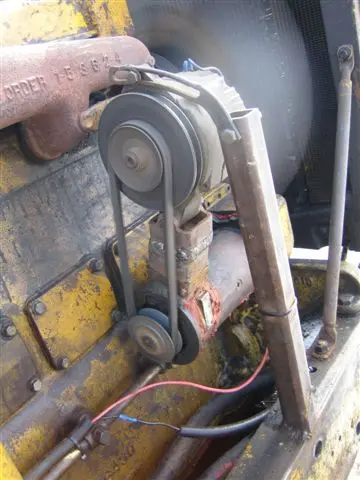

kracked1
Posts: 741
Don't know anyone supplying that version as a kit.
Here is the conversion I just finished. Turned out pretty good I think.
Tue, Mar 31, 2009 8:17 AM
