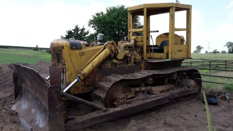

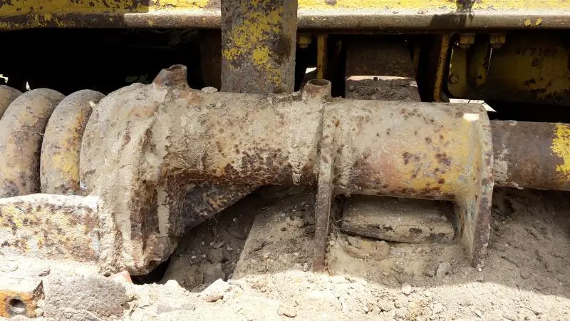

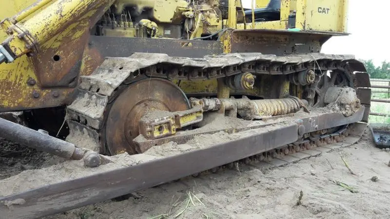

Hello all, I recently purchased a D6 8U, which had been sitting for 5 years, with an uncapped exhaust. Managed to get the old girl fired up, and actually drove 6 miles home. Probably wasnt the best idea, but this is all new to me. She seems to run good, has a electric start, wet clutch. And maybe working hydraulic track adjusters?

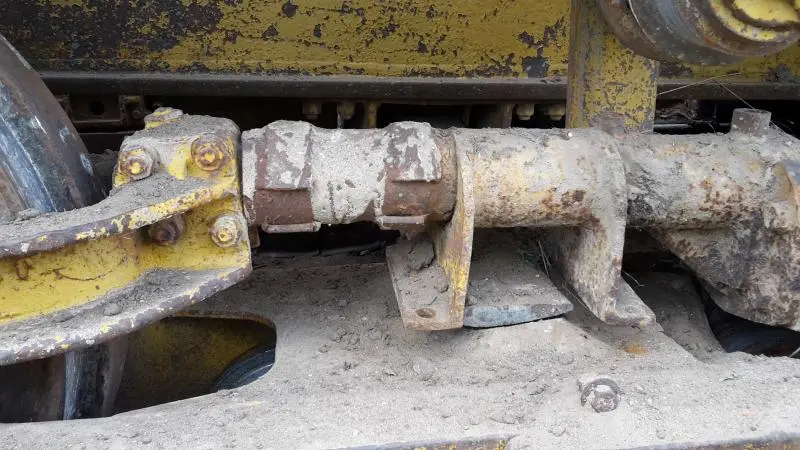

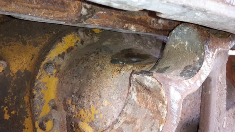

The bolts that hold the support are broken off, I cant tell whats going on with the shaft, and the idler wheel seems to be moving around in the yolk. (Score marks on the side of the wheel.) I picked this machine up for cheap enough that I was just going to use it for what I needed, and not really worry about the issues, but the chain is starting to wear through the final drive cover. It was wore before, but only going to get worse. Probably have around $800 spent on fluids, and batteries combined, at this point also.
Anyone by chance have any tips on how to proceed, or know of any used parts around central Kansas? I just recently moved out to the country, and dont have my tools or welding equipment set up at all yet, but hoping I can figure out something.

You will find hook type things that run on wear strips on the inside of the track frame . In your case these are worn out and the track adjuster is trying , unsuccessfully , to keep the idler aligned .
You need to break the track then remove the idler and do whatever repairs needed to restore the aligning surfaces on the hooks and inside the track frame .
The track adjuster also needs work.
Probably using wrong terminology here .
The other side most likely needs doing also.
Good luck.

Andrew, thank you. To be honest I hadn't thought about having to break the chain, till you mentioned it. Also seen how things are connected, but didnt know about the wear strips. Not fully studied into the parts manual yet.
I think I know what happened now, as I tried to get the machine to raise the front with the blade this evening. The part I'm calling a support bracket also connects the front spring to the track unit. The bolts in that bracket have rusted and broke free sometime in its life. Instead of repairing it then, the left it, and over time it has bend the shaft through use. Though not sure what the sleeve or whatever junk welded over the rod is for, unless its broke, or failed hydraulic.
The broken off bolts in the track frame are buried in there pretty deep, going to be a pain. The other side is in a lot better shape, the idler wheel is even still fairly yellow.

From 1500 miles away that looks like the original screw adjuster. The handy dandy add in piece is a poor mans make do shim?
The original had a grease fitting with the idea of some lube to keep it from rusting up,(my opinion) didn't help much but sure didn't hurt.
For now pull the idler ahead and see if you can get a look inside the shim.Then add more shim for the cheap quick fix since the money tree is not in full fruit right now. If more than a few hours work you need to shim the yolk or at least add something to keep it down. As they say "a poor man has poor ways", but we all know in the long run cheaper do it right to get the most us out of machines.

If the guide bolts for the adjuster are broken then that's the reason the yoke is tweaked. That bracket is also your equalizer spring retainer. That's what keeps the front end of the tractor from rearing up. Letting the track stay loose on the 8U has been known to let the rails cut clear through the final drive housing and/or into the side of the tractor main case.

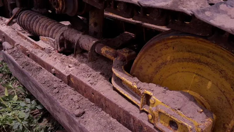

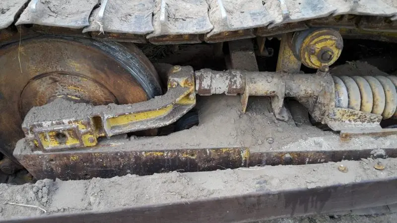

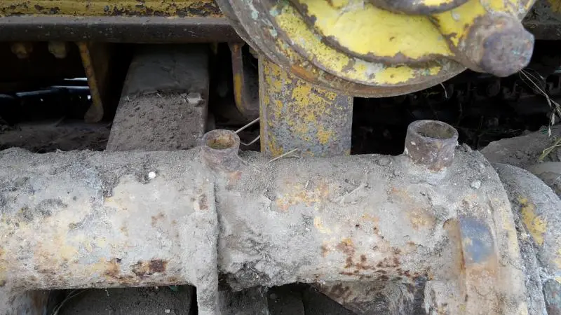

Ray54, I think they're hydraulic, but I'm including some more pics with this post. Dont see anywhere for adjustment on the good side. The little cups on the top have zerks down in them. Though it looks like the front ones are close to being sheared off by the guide/equalizer spring retainer. You're right about the shim, I'm thinking it was added before the bolts broke.

yep those are hydraulic adjusters. no need to buy new ones,just clean up those and put new seals in them. the bolts holding the adjuster assembly down to the track frame are broken or missing on the affected side and it looks to me like the hydraulic adjuster needed seals so the PO just shimmed instead. just clean her up and disassemble the bad side and then you will understand and know what you need. probably a lot of work but not much money to fix in my opinion. but we haven't answered what condition the track chains sprokets rollers etc are in either. it isn't safe to operate in it's present condition.

I am't sure but these track adjuster are't hydrolic the greasse fitting are for greasse the rod tread in the nut assembly 4f9145 and the idler have no bearing on shaft it is boushing and the idler side scratch it should be a loose strip trackframe make it and the equalizer spring retainer need bigger bolts.

All this damage to the tensioner and the spring retainer is caused by the failure of the wear pads each side of the idler , inside the track frame .
It is pointless repairing the above items without first removing the idler and doing whatever repairs are necessary here .
The wear in the idler guides is most likely what caused the adjusters to fail in the first place .
The PO instead of fixing it properly then did a bodge job fitting the spacer blocks to the adjusters .
Then damage escalated from there to where you see it now.
Others should be able to post a scan of the idler guides so you can understand what is going on.
The idler guides often can be relatively inexpensive to repair, only needing replacement of wear strips and a lot of weld build up .
