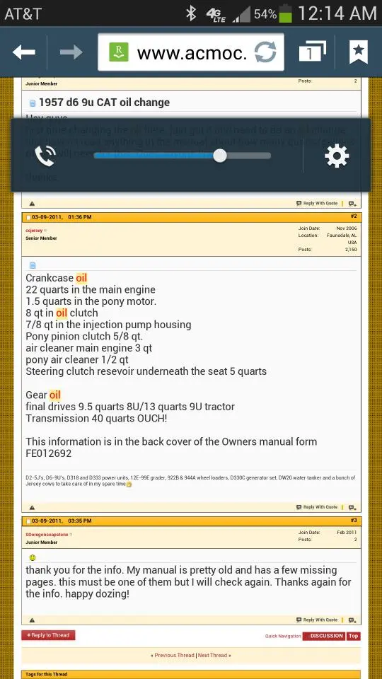

Hello, seeing if anyone knows the oil, coolant, final drive oil, pony oil and transmission fluid capacities and weights/ types for my 1946 D6 4R. The manual is in the mail but just cant any longer. Also, do I install the oil filters wet with oil or just dry. And if there's anythings to keep in mind when changing all these fluids I would love to know! Thanks again.

Ok.. can anyone explain whether or not the D6 9U specs are the same as the 4R. I was told the machines are very similar.

the final drives and transmission will be the same on a 4r compared to a 9u. Same as the pony, air cleaner and pinion clutch quantities. a 4r does not have a wet clutch so ignore that quantity. the injection pump and diesel engine crankcase will be very similar, but may vary as they are different on a 4r with the d4600 engine compared to the d-318 on the 9u.
Thank you. I think ill wait for my manual to come in the mail.
