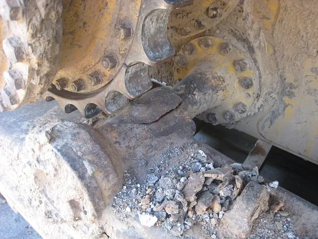

The only issue I have heard about is the track frame pivot shaft having busing wear and if not attended to can lead to cracked pivot bearing housing. More common to the D6 high track but same conditions apply.
is the housing a part of the track frame or the tractor? if cracked is it obvious or do you have to dis assemble to find it? is a cracked housing repairable or does the track frame have to be replaced?

I'm more aware of the D6 arrangement. The bushing housing is part of the track frame. There is a procedure for repair but it's a bear to do.
Here's a pitcher of the damage on the D6N. I would be looking at this area closely on the D4H and any sign of track frame miss alignment.
Thanks Magnet.
i did some research on this problem and discovered that housing is oil filled. so a good inspection should include checking oil level in those compartments.
